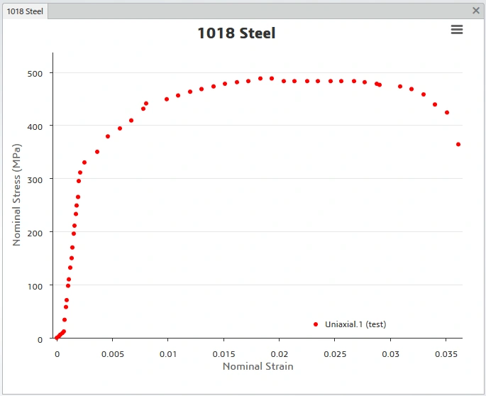

The test data shown above can be found here:  1018 Steel
For the R2026x FD01 release of the 3DExperience Material Calibration App we have added a new feature to the test data editing functionality called "Truncate", or we could say "Truncate at Peak".  When working with metal plasticity stress-strain curves, it is rather common that one wants to truncate the test data at the nominal stress peak.  In prior versions, one would delete all the points after the peak, but it might take some time to determine the exact peak.  This convenience feature speeds up that process.  In the video below I have demonstrated this new feature.  As is noted in the video, you are also allowed to truncate the test data based on a user entered value.
