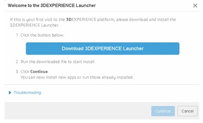

Hello Makers,
If you are seeing a repeated download prompt for the 3DEXPERIENCE Launcher or are unable to open SOLIDWORKS Design (or other desktop-installed apps) from the web 3DCompass, then you may need to allow local network access for the 3DEXPERIENCE Launcher within Chrome and Edge.
1.1 - Allow Local network access when launching the 3DEXPERIENCE Launcher
- If you see a popup saying: “Look for and connect to any device on your local network”, then Click “Allow”.
- If the popup is not displayed, then Click “View site information” (button is to the left of the address bar) and Activate the permission for “Local network access”
