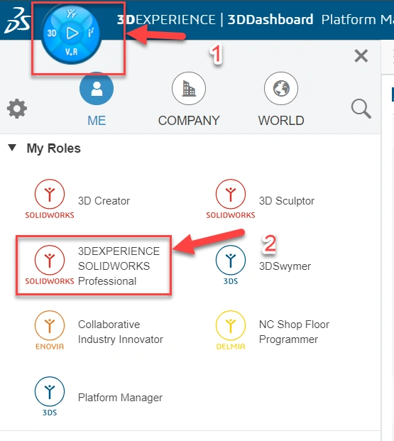

The fix for this problem has been delivered with 3DEXPERIENCE R2026x HotFix 1.8 for SOLIDWORKS® Design app. Log in to your 3DEXPERIENCE platform, open the Compass, click the context menu next to the SOLIDWORKS Design app, and click the orange 'Update available' icon to initiate the download and installation of the new version.

The fix for this problem has been delivered with 3DEXPERIENCE R2026x HotFix 1.8 for SOLIDWORKS® Design app. Log in to your 3DEXPERIENCE platform, open the Compass, click the context menu next to the SOLIDWORKS Design app, and click the orange 'Update available' icon to initiate the download and installation of the new version. You can reference the screenshots below.
