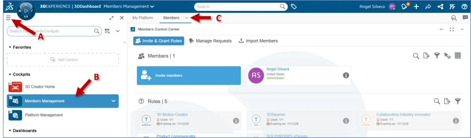

- Log in to your 3DEXPERIENCE platform.
Open your dashboard list and click on the Members Management cockpit, then click the Members tab.

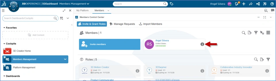

Click the (i) icon next to your name.
- Click View roles granted, and then clear the checkboxes for the following roles to ungrant them:

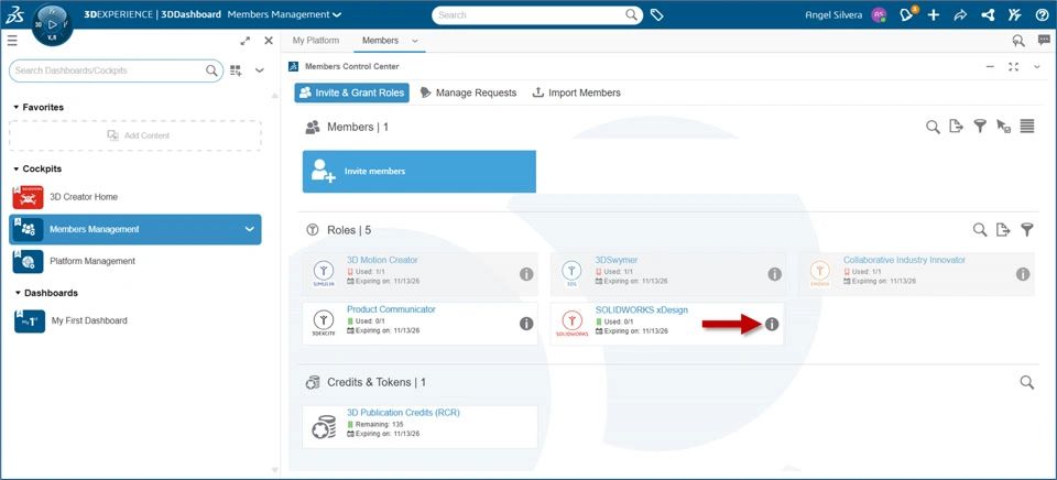

Under Roles, click the (i) icon for SOLIDWORKS xDesign.

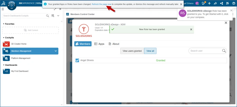

A pop-up window will open. Click “View all”, then check the box next to your name and any other users you want to assign the role to.
You’ll see a green “Granted” confirmation message. Click “Refresh the page now”.

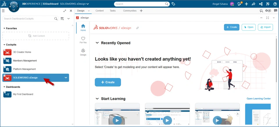

Return to your Dashboards list and click the new SOLIDWORKS xDesign cockpit to start designing.
