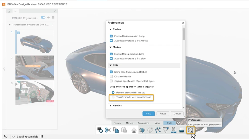

To enable this transfer of viewpoint from, you need to select the “Transfer Model View to Another app” checkbox in the app preferences. Also, the contextual assembly must be open in the desktop-based design app before performing the slide drag and drop operation.
