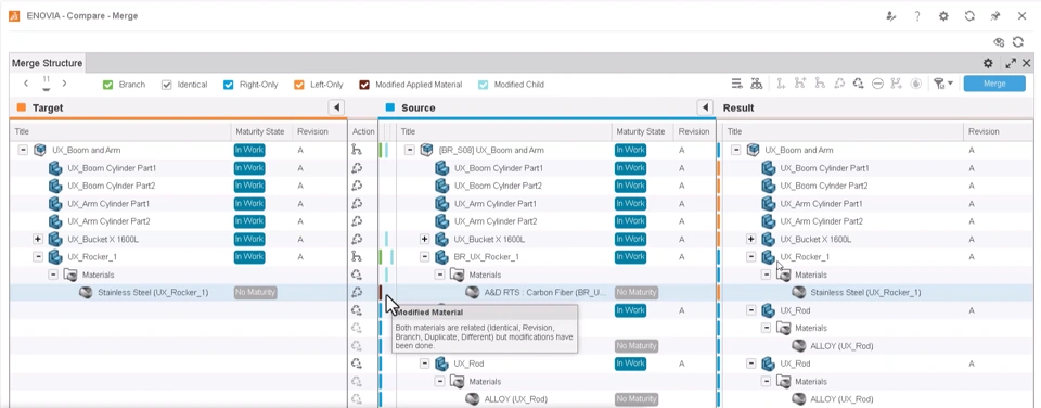

Initiating the Merge operation from the successful study branch opens the Revision Explorer panel, revealing all other available branches and the source structure. Once you select the Source structure, the Compare app is launched displaying structural & 3D comparison with a cross-highlight feature, for eased decision-making during the merge.
In the Compare app settings, you can then select the Show Materials option to enable the material display during the comparison. This shows dedicated color codes indicating the differences between the applied materials, for eased decision making.
For example, the ‘Modified Applied Material’ indicates that, for the same part, a different material is used.
In the above example, the following three tabs are displayed:
  • Target: Represents the Primary Structure
  • Source: Represents the Branched Structure
  • Result: It is a Simulation of the Target structure after the merge operation.
How does it work
Select the material row and choose between Keep Source or Keep Target to determine which material to integrated into the resultant structure. Then click on the Merge command to initiate the operation based on the selected actions.
As a result of the merge operation, the selected design & material changes are merged into the original structure.
