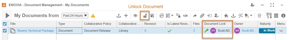

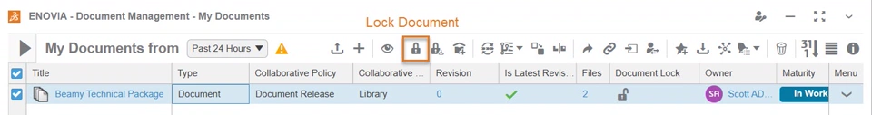

Lock a Document
A 'Document Lock' secures the entire Document, including its attributes and all associated files. It prevents any other users from making changes.
This option is best suited for document maturity phases such as release preparation, approval workflows, or compliance reviews where strict control and consistency are required.

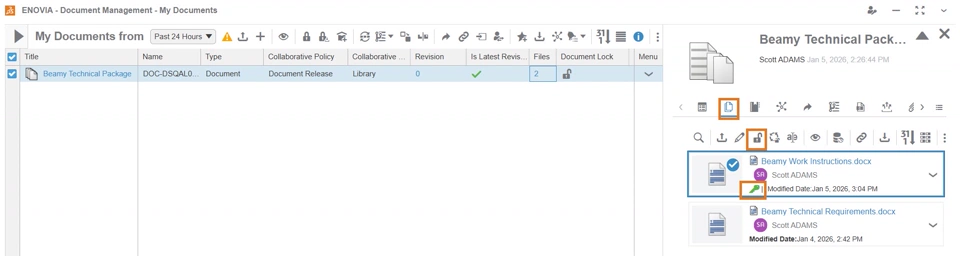

Lock a File
A 'File Lock', on the other hand, applies only to selected file(s) within a Document. In this case, other users can continue updating Document attributes and/or working on different unlocked files at the same time. This approach supports day-to-day collaboration, allowing multiple team members to contribute in parallel without blocking each other’s progress.

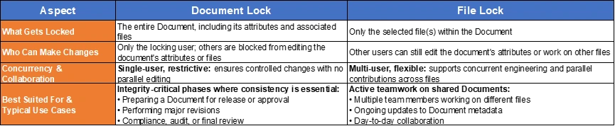

The table below summarizes the key differences between 'Document Lock' and 'File Lock'.

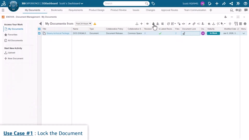

The video below illustrates both use cases:
