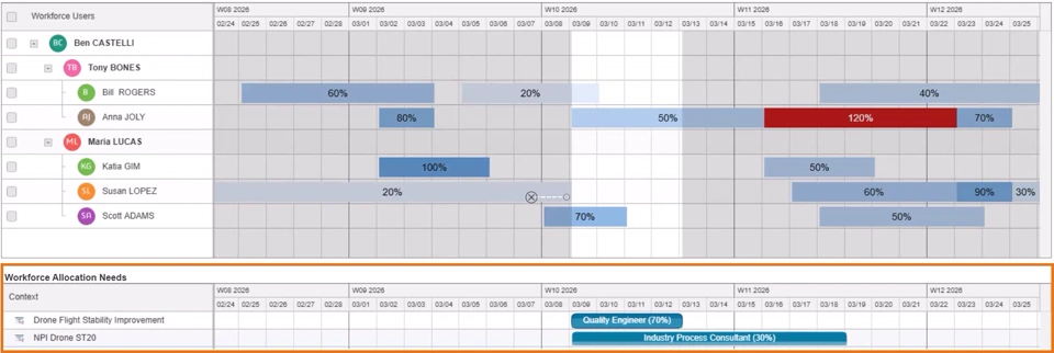

The 'Workforce Allocation' view is divided into three main sections:
Section #1 - Workforce Users:
This section provides a comprehensive overview of the team's availability and workload.
It consists of two parts:

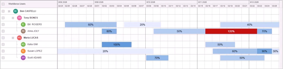

User List (left panel): Displays all users within the logged-in Resource Matcher's organization who are eligible to be assigned workforce requests. The list is organized based on the organization’s supervisory structure.
Workload Timeline (right panel): Visualizes each user’s workload over time as a percentage.
Here is how the workload is color-coded for a quick assessment:Blue (0-100%): Indicates the user is fully available (0%), partially available or totally unavailable (100%).
Red (over 100%): Indicates that the user is overbooked.
The color-coded bar allows Resource Matchers to assess capacity at a glance.

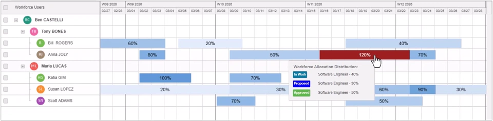

For deeper insights, you can drill down to view:
All assigned requests
The contribution to the workload (%) of each request
The maturity state of each request
This transparency ensures you have a detailed understanding of resource utilization.

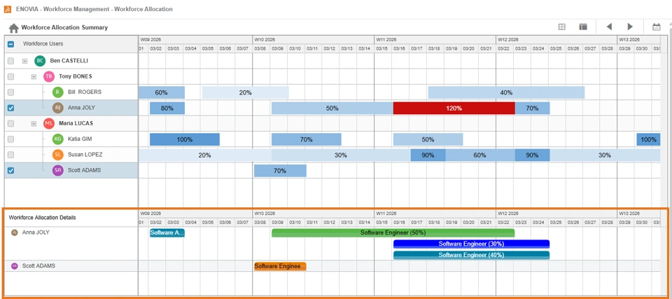

Section #2 - Workforce Allocation Details:
This section provides a detailed breakdown of allocation details for one or more selected users, ensuring Workforce Managers can easily track and manage individual workloads with precision.
By default, this section is not displayed.
To access it, select one or more users in the 'Workforce Users' section.
Then, you can view a detailed timeline of users assigned workforce requests, color-coded by the maturity state of each request.
Section #3 - Workforce Allocation Needs:
This section focuses on unallocated or pending (In Work) workforce requests assigned to you as the Resource Matcher that require staffing.
Requests are grouped by project (context) to provide structured visibility and easier prioritization. You can open each request’s properties to review its specific details and requirements.
