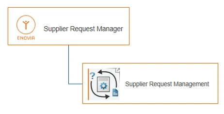

At the core of this solution is a single application:
  • 'Supplier Request Management' application
    This app is used to create Technical and Sustainability Requests, share them with suppliers, and review and analyze their responses.

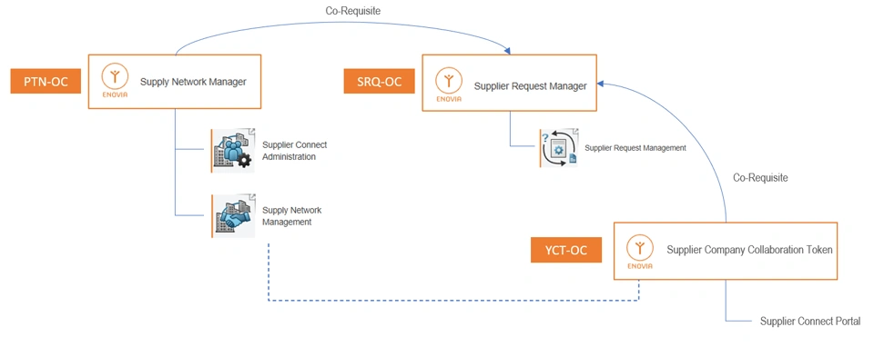

To do that you have two other ENOVIA roles, which are co-requisite of the 'Supplier Request Manager' (SRQ-OC) role:
  • 'Supplier Company Collaboration Token' role (YCT-OC)
  • 'Supply Network Manager' role (PTN-OC)

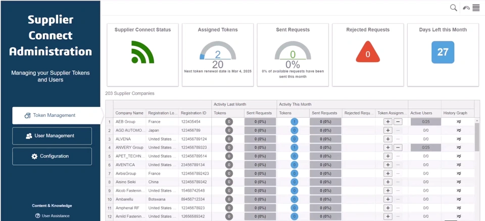

The 'Supplier Company Collaboration Token' (YCT-OC) is a license role. It is not a user-based role. It is the mechanism / token that allows you to activate the communication channel between your company and your Suppliers.

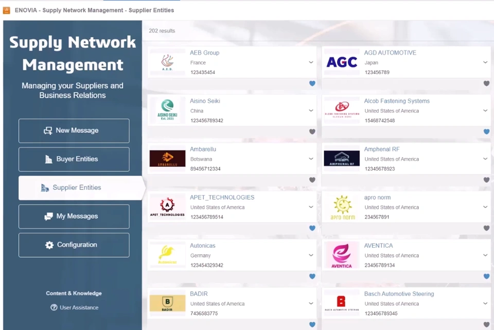

The 'Supply Network Manager' Role (PTN-OC) contains two applications:
  • The Supply Network Management app, which allows you to create suppliers, supplier users and manage their information and relationship definition in the 3DEXPERIENCE Platform.
  • The Supplier Connect Administration application allows you to allocate the Token to the Supplier Company, enabling its users to access the Supplier Connect Portal.

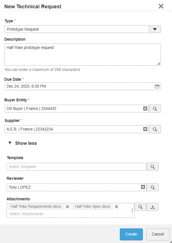

Step#1 – Create a Request and send it to a supplier.

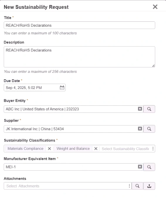

Create a request using a predefined template or start from scratch.
Add key details such as the due date, request type, instructions, selected supplier, attachments for supporting information, and the approval workflow or reviewer.
For Sustainability Requests, additional elements are required, including the Manufacturer Equivalent Item (MEI) for which you are requesting metrics information, as well as the specific sustainability metrics to be provided.

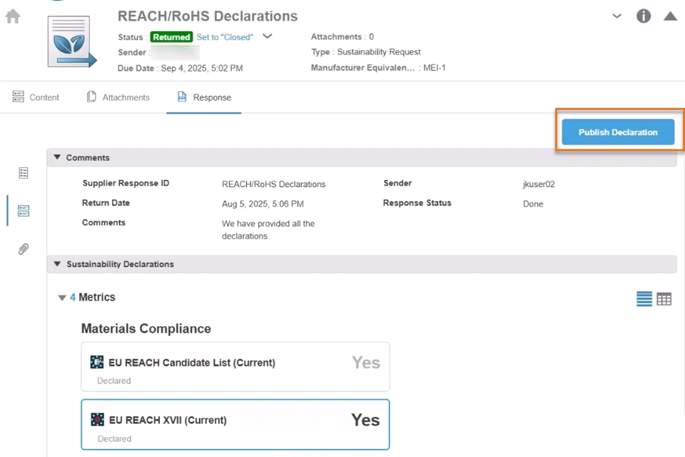

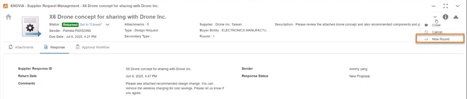

Step#3 – Review & manage the supplier response
Once the supplier returns their response, the response is available in the Response tab in the 'Supplier Request Management' application.
The request's owner can review the response, and decide if a new round is needed or not.
A round acts like a new revision of the request, and initiated when further clarification or communication is required.
For Sustainability requests, you can choose to publish the Declarations provided by the supplier.
When a Supplier Declaration is published, the system automatically updates the definition of the corresponding MEI.
Once published, you can:
  • Use the ‘Material Compliance Assessment’ app, which is available with the 'Materials Compliance Engineer' (MCV-OC) role - to perform compliance analyses and view compliance status across all configured regulations.
  • Use the 'Weight and Balance' app, which is available with the 'Weight and Balance Manager' (KPW-OC) role - to analyze, assess, and compare objective values with the evaluated (assessed) values.
