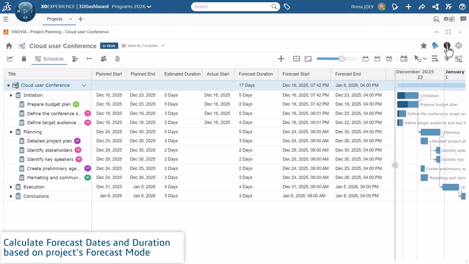

Calculate Forecast Values in Project Planning web application:

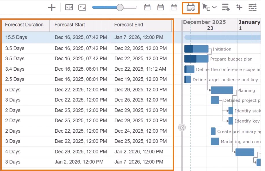

To calculate forecast values in the ENOVIA Project Planning web application, including - Forecast Duration, Forecast Start Date, Forecast End Date, and Calculation Timestamp, use the 'Calculate Forecast' command available in the Schedule facet toolbar.
This command is available in both Table View and Timeline View and calculates forecast values for all tasks, milestones, and the project, based on the project’s configured Forecast Mode.

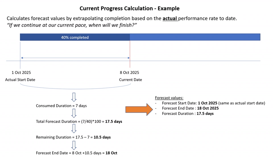

  • Current Progress (Default)
    Calculates forecast values by extrapolating completion based on the actual performance rate to date. This mode answers the question:
    “If we continue at our current pace, when will we finish?”
