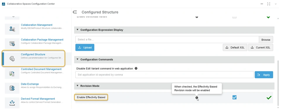

Pre-requisite (Admin Setting)
The following setting should be activated (by the admin):
  • Navigate to:  Collaborative Spaces configuration Center > Configured Structure
  • Enable the option: "Enable the Enable Effectivity Based option.
What will this setting enable:
This will make the Revision tab visible for users creating a new Engineering Item.
Users can then set the “Revision Mode” to be “Effectivity Based” when creating the root product.
This setting is available from the Revision tab in the Engineering Item creation panel:

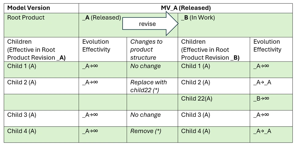

(*) a new revision is created using the “Effectivity based” mode. Let’s call it ”_A” as in the example below to distinguish it from the standard Engineering Item revision (A)
Example:
The Model Version (MV_A, released) stays released and not revised in order to perform the changes mentioned in the table below. Instead, the released Root Revision (_A) will be revised for that purpose (_B):
In this approach, child items have Evolution Effectivities in the context of the root revision (_A, _B).
