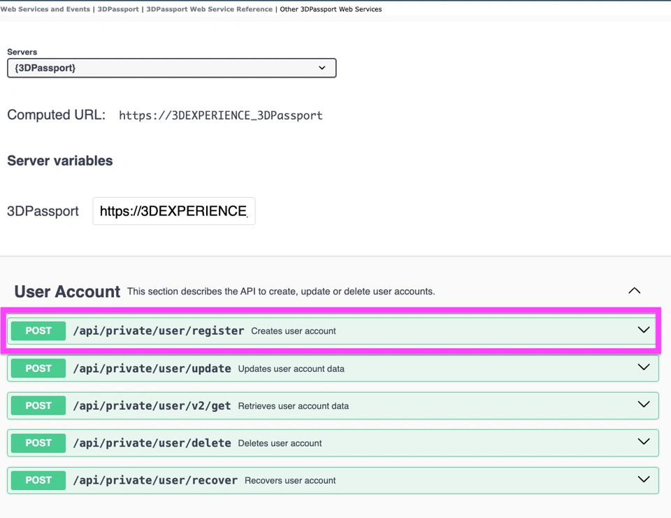

I'd like to get some help on which APIs or web services I can use for Person creation, and how they connect to the 3DPassport API for users (see image below).
I was eble to create a user using the 3DPassport API /user/register but even if the user exist in 3dpassport that user cannot access the platform. I'm guessing something is missing on the Person/Collaborative Space side, or some additional step is required to link the 3DPassport account with the Person object in the platform.
