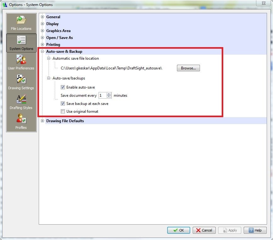

An auto-save option is used to save a drawing automatically after specific intervals. It is an option provided by DraftSight to store your drawing on which you are working. So that, if something unexpected happens you will have the copy of drawing. You can set option related to autosave from Tools menu >Options>System Options> Auto-save and Backup.

Generally autosave files are located in ‘temp’ folder of your system.i.e. C:\\Users\\username\\AppData\\Local\\Temp\\DraftSight_autosave. However to quick access autosave files go to windows start menu and type ‘%temp%’ and go to folder ‘DraftSight_autosave’. Additionally you can change default path from DraftSight Options.

This is one more tool to recover drawing data. Back up files(.bak) are created every time when you save drawing. These file are saved with extension .bak in a same location and same name where a drawing is saved. Only one bak file is stored at time hence after saving drawing newly created .bak file replaces the older one.
To enable this backup files creation you need to check option ‘save bakup at each save’ from DraftSight Options. Similar to autosave file you need to rename .bak file to .dwg extension for use.
