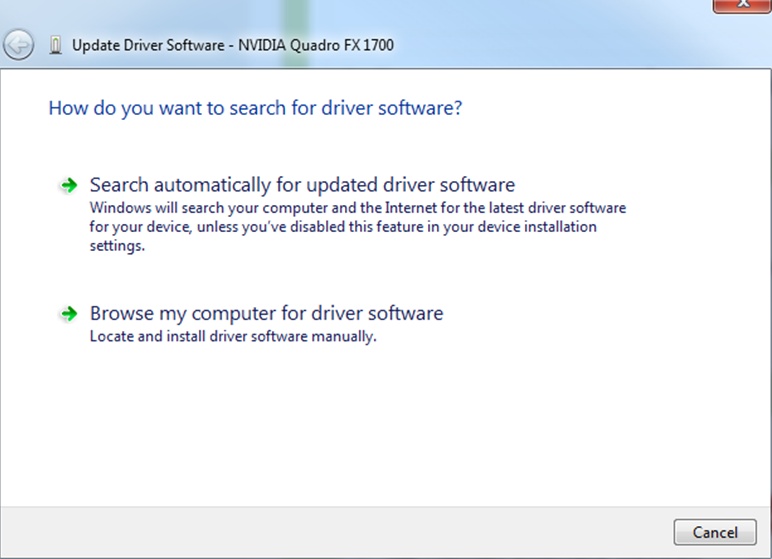

  6. Click on the video card shown and select ‘Update Driver Software...’.
7.  In the dialog pick ‘Search automatically for updated driver software’.
8.  If windows found a new driver, update your computer.
