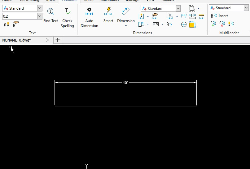

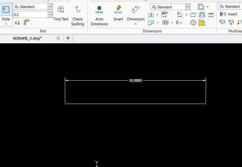

Following images explain different dimension formats in detail:
Decimal Format:
 Architectural Format:

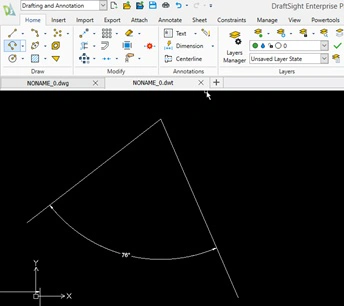

  • Steps to change these Angular unit Dimension Formats in DraftSight:
  1. Go to Tools>Options>Drafting styles> Dimension>Angular Dimension> Angular Dimension
  2. Change the format as per your requirement
  3. Click 'OK'

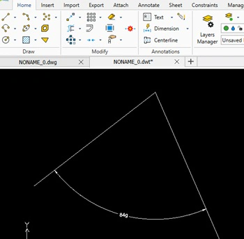

          Following images explain different angular dimension formats in detail:
  Decimal Format:
  Grads Format:

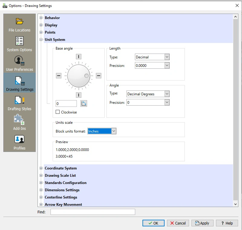

  • Using the UN Command:
This command lets you change Format and Accuracy of the dimension units.
  1. Type UN (UNITSYSTEM) command and press ‘Enter’.
  2. In Unit System Dialogue Box, select required option for Type and precision. (Default Format is set to ‘Decimal’ and Unit Scale to ‘Inches’
  3. Click ‘OK’.
         Options-Drawing Settings Dialogue Box in DraftSight:
Changing Unit System changes the format, precision, and other settings used to display coordinates, distances, and angles in specific dwg file.

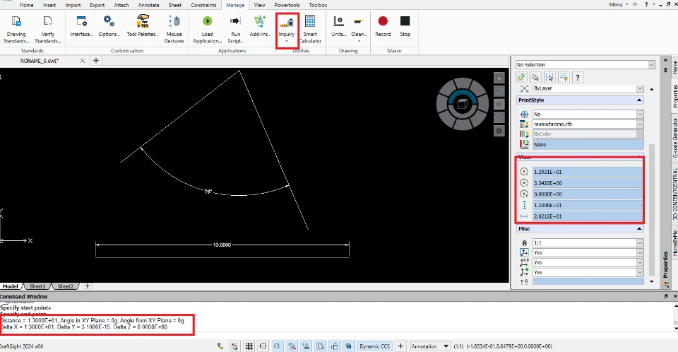

To check the changes in Unit System, follow below steps:
  1. Type command ‘_GETDISTANCE’ or go to Manage> Inquiry
  2. Select start and end point.
  3. Check the dimension in command window and in Property Panel
You will notice dimension format is updated as per the setting selected in Unit System dialog box.
           Check below image visual reference:
