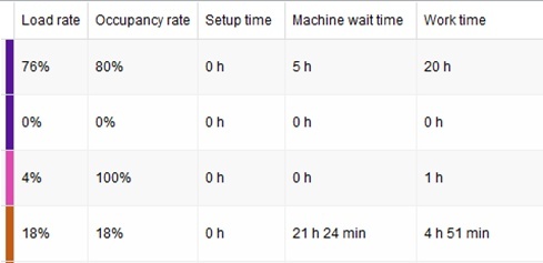

In total, 6 indicators dispatched between WO Gantt chart and Machine have been added as new columns.
On Machine Gantt Chart :
Load Rate: ratio between the duration of all the operations on the machine, including their setup times, and the planning horizon minus the machine downtimes
Occupancy Rate: ratio between the duration of all the operations on the machine, excluding their setup times, and the working horizon of the machine.
Setup time: Sum of the tool and parameter changeover times on that machine, in days.
Wait time: Difference, in days, between the planning horizon and the duration of all the operations on the machine + the machine downtimes.
Work time: Total duration of all the operations on the machine in the plan, in days.
On WO Gantt Chart:
Residence time: Real duration of the WO in the plan corresponding to
End date of the last operation of the WO - Start date of the first operation of the WO

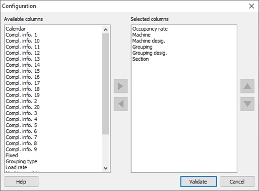

2. Configuration
All the indicators can be added and/or configured in the left margin of the WO and Machine Gantt chart by selecting the corresponding indicator:
