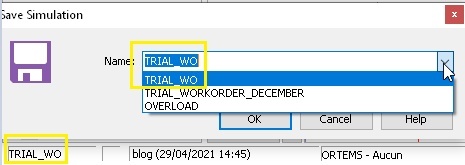

- When saving a simulation, having selected the currently used simulation by default in the list
- In Planning status bar, a tooltip text information is display with the full name of the simulation
 Before the Refresh 6, when a simulation was saved: the first selection available was sorted in alphabetical order, which could lead to issues.
Reminder:
All information concerning simulation are available in our Best Practice:
Simulations in DELMIA Ortems - Description, Usage and Technical Design
https://media.3ds.com/support/white-papers/adv_ent/external/2021/DS_WhitePapers_Simulations_in_DELMIA_Ortems_Description_Usage_and_Technical_Design_2021_V1.0.pdf
To save the current plan as a simulation, from the menu bar, select File > Save Simulation.
Since Refresh6, the currently used simulation is proposed by default
When managing simulations, we may need to use a name quite long, up to 30 characters.
The status bar displays the name of the current simulation (or "ENCOURS" is we are working on WIP) but the number of characters displayed may not be big enough.
Since Refresh6, a tooltip is present to display the full name of the simulation
