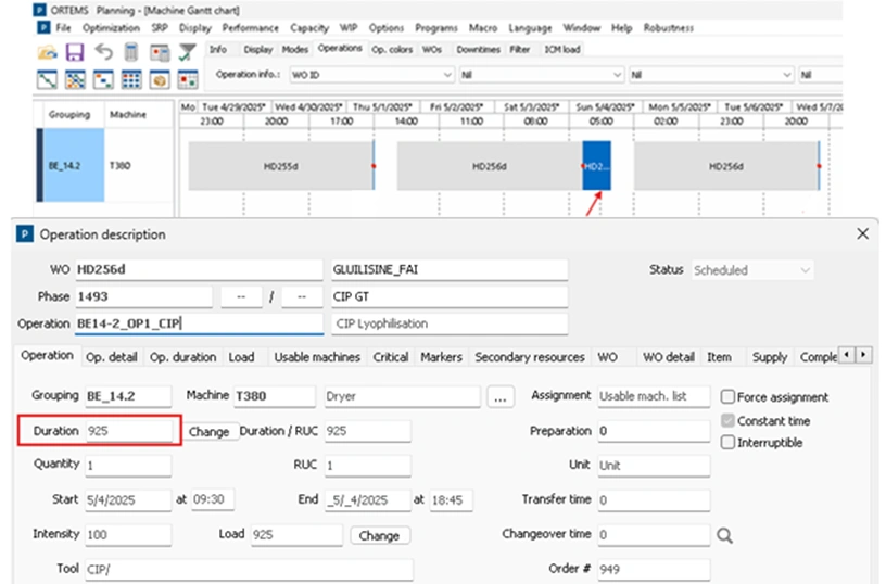

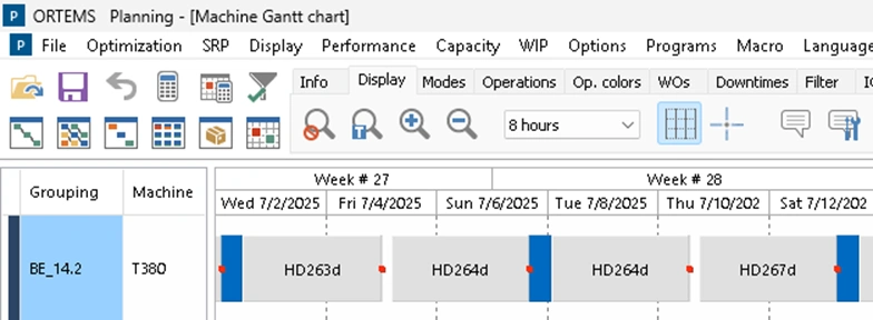

The potential operations are highlighted in blue (Operation filter: Potential = ‘Yes’ AND Active=’Yes’)
According to the rule above, a potential operation is activated as soon as 2 different WOs are executed (i.e. operations belonging to 2 different WOs). The second potential operation is activated once the 2 WOs were planned: ‘HD263d’ then ‘HD264d’ (even if the next WO is the same ‘HD264d’, the potential operation is immediately activated after these first 2 distinct WOs).
Once configured, the potential operations are already present in the planning but will be activated only if their defined condition is met.
Below is the ACTIVE potential operation:
The duration of the changeover time defined is 925 HH (See ‘Enablement’ section below).

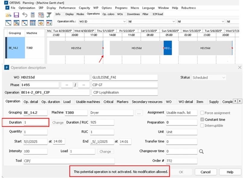

Below is the INACTIVE potential operation:
The duration is always 1 HH (i.e. 36 seconds)
Modifications are not permitted on an INACTIVE potential operation.

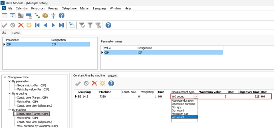

At Item discrete parameter level
Here is the configuration in Data Module application: open ‘Setup time’ > ‘Discrete parameters’ menu: Define the calculation method as 'Const. time' in Changeover time > By machine.
There are several rules to trigger the changeover time (i.e. to activate the potential operation). As shown on the screen above, the rule has to be selected in the ‘Measurement type’ field.

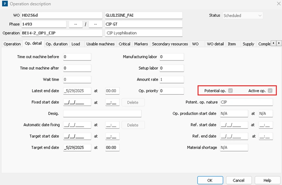

At Generic operations level
The "Potential" check box must be selected.
Also, for a potential operation to be active with for example a 'CIP' parameter, that operation but also the operations triggering the end of the cycle must have the same 'CIP' parameter.
The ‘Nature’ field is for information and is visible in Planning application in 'Operation description' screen. It can be modified, but it won’t have any impact on the calculation.

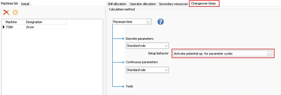

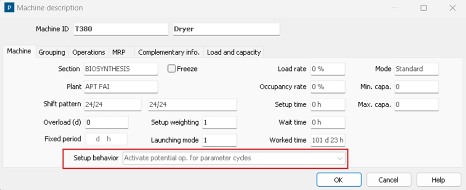

At Machine grouping level
  1. In Data Module via Resources > Machine groupings, in ‘Changeover times’ tab: select ‘Activate potential op. for parameter cycles’ for Setup behavior.
The global time calculation method has to be set on ‘Maximum time’ or on ‘Sum of the times’ in the case where 2 parameters are active on the same time.
This setting is visible also in the Planning application in read-only mode, in ‘Machine description’ screen

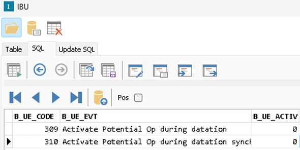

The activation of potential operations was already possible via a User Exit.
To avoid affecting the UE proper functioning, the new ‘Potential operation activation’ feature is disabled when such a UE is detected.
The following query highlights the parameters activating such UE:
SELECT * FROM B_UE_SUBSCRIBE WHERE B_UE_CODE in (309,310)
The new feature 'Potential operations activation' is not applicable as long as at least B_UE_CODE ‘309’ or ‘310’ parameter is enabled in the B_UE_SUBSCRIBE table.

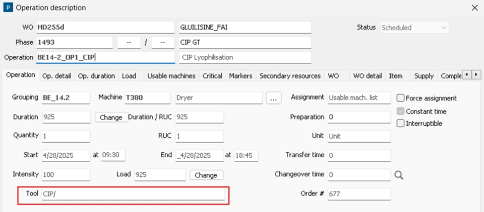

At 'Operation description' level
  1. 'Op. detail' tab:
  2. 'Operation' tab:
The ‘Tool’ field contains the tools and the item parameter values (it does not contain the parameter ID nor its designation)
