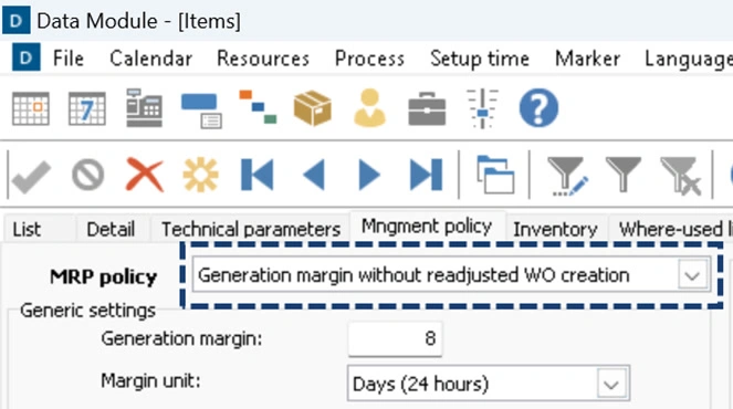

1/            New MRP policy
The “Generation margin without readjusted WO creation” policy allows to avoid creating readjusted work orders (WOs) for semi-finished goods (SF) during the SRP calculations.
This policy is set at the item level within the Data Module application, specifically under the "Mngment Policy" tab.
New policy “Generation margin without readjusted WO creation”

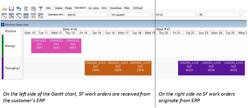

3/            Example
BOM definition
**ORANGES quantity required to produce 1 ORANGES_JUICE = 1
**LEMONS quantity required to produce 1 LEMONS_JUICE = 1
Initial situation

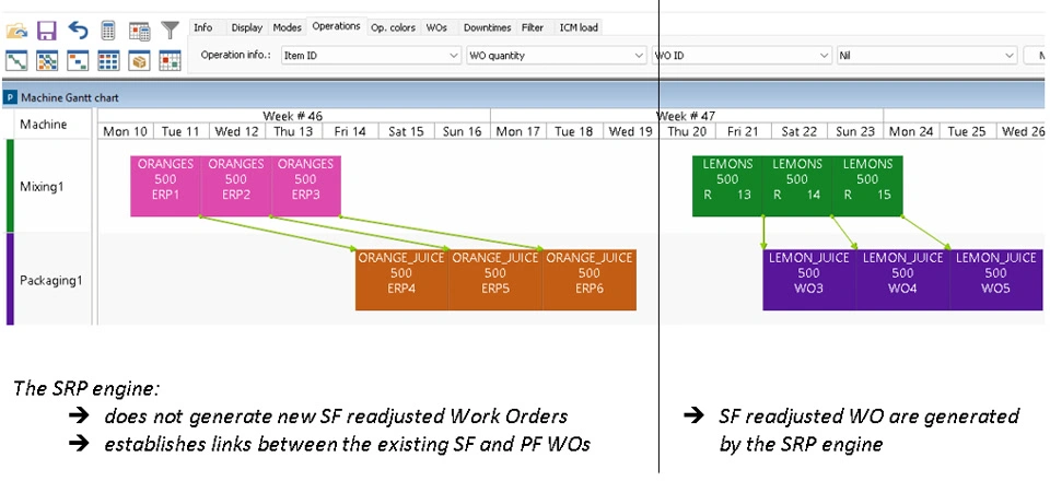

After SRP computation
Please note that the chosen example is intentionally simplistic. The above scenario applies equally to the links between a Semi-Finished supplied WO (compound) and a Semi-Finished supplying Work Order (component).

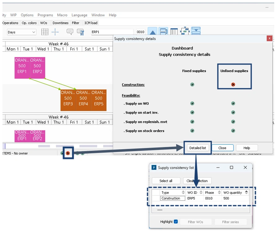

4/            Consequences
In the context of the “Generation margin without readjusted WO creation” policy, the SRP will not generate any readjusted WO to bridge the gap if there's insufficient quantity of SF Work Orders.
Please refer to the following example:
Initially the current SF Work Orders are insufficient to meet the finished product WO requirements.
Initial situation
Following the SRP calculation:
A readjusted WO (“R      12”) is generated to cover the LEMONS SF quantity shortage
Whereas no new ORANGE readjusted WO is generated to cover the SF quantity shortage.
In this situation, the Planning status bar will indicate an unresolved supply issue, denoted by a red cross icon
Double-clicking on this icon enables accessing more information and the 'Detailed list' button highlights the Work Orders associated with these unresolved supplies.
