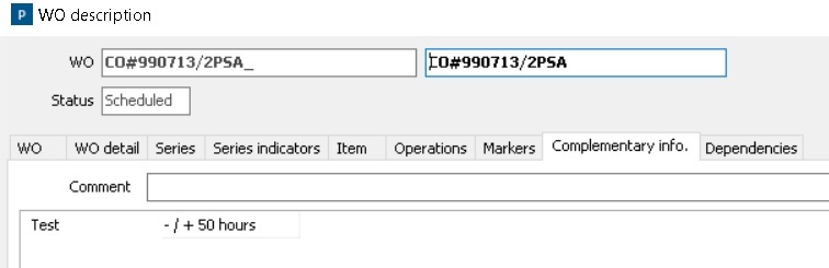

For Work Order entity

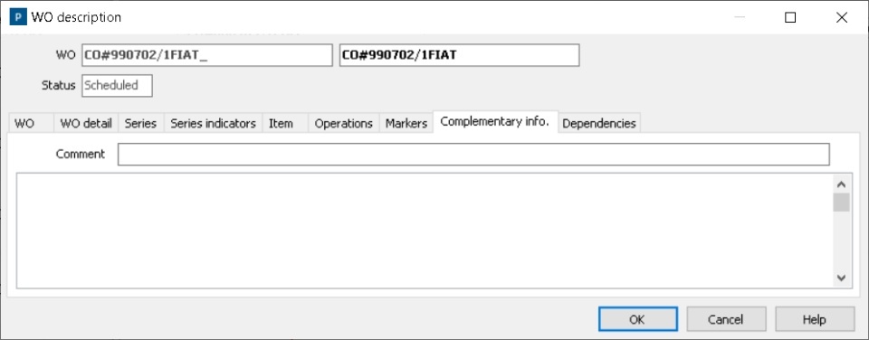

By opening the ‘WO description’ window:
- double-clicking in the left margin of an Work Order Gantt chart (like an ‘WO Gantt’ or a ‘WO focus Gantt’ chart)

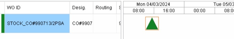

- by clicking on the Stock Order triangle when using ‘Display mode’ (right click > Display)

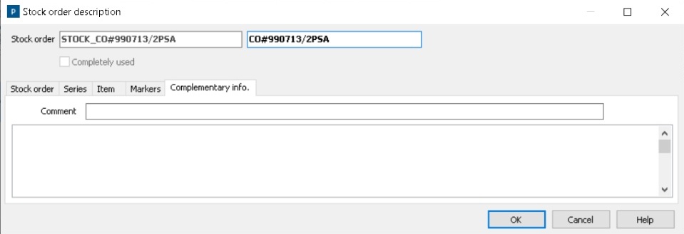

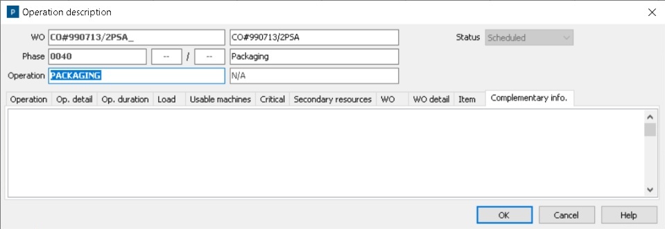

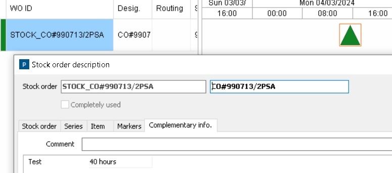

Then the ‘Stock order description’ window appears:

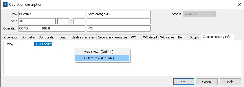

Adding a Complementary information row

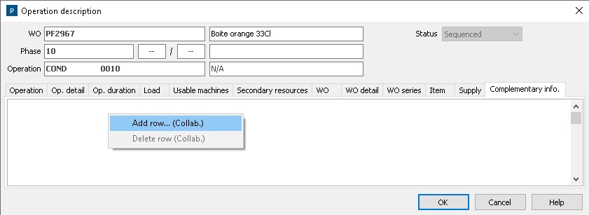

Whatever the entity WO, Operation or Stock Order, adding a new row requires to right click over the ‘Complementary info.’ tab and select ‘Add row… (Collab.)’:

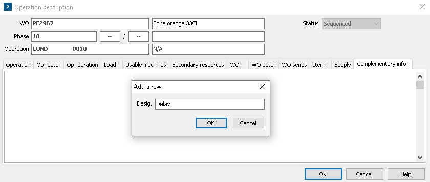

Specify then a designation for the new row:
Then it is possible to enter a text for that new complementary information:

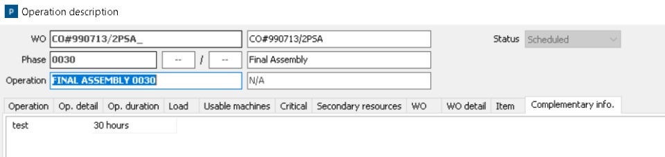

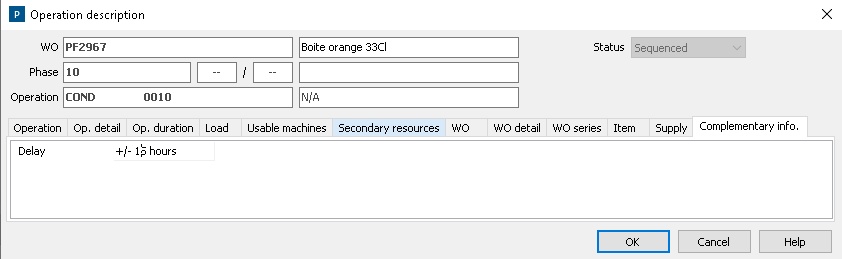

Modifying a Complementary information row

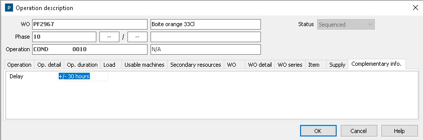

Clicking in the text allows to modify its content:

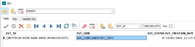

‘Add row’ action generates the ‘ADD_COMPLEMENTARY_INFO’ event
In EVENTS table:

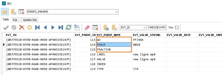

In EVENTS_PARAMS table:
For Operation entity, the matching record set specifies Work Order Id, Phase and Fraction.
For Work Order and Stock Order entities, the matching record set specifies the Work/Stock Order Id, not the Phase neither the Fraction.

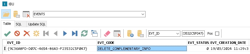

‘Delete row’ action generates the ‘DELETE_COMPLEMENTARY_INFO’ event.
In EVENTS table:

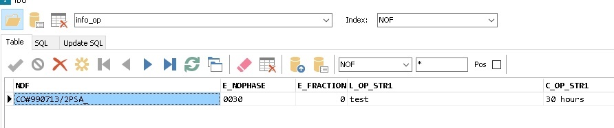

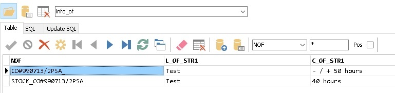

Once the Planner user has validated the collaborative events
Once the Planner user has validated the collaborative events by saving WIP, the effects can be observed in:
- “INFO_OP” table for Operation Complementary information:
- “INFO_OF” table for both WO & Stock Order ‘Complementary information’:
