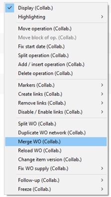

Among all the possible actions in the Planning application, some of them, already usable by Planner users, are now offered to Collaborative users.
This means that these actions send collaborative events to the Planning program.
These 3 new actions are the following: Duplicate WO network, Fix WO supply and Merge WO
Here is a recap of all the planning collab features now:
A glimpse of the introduced collab events

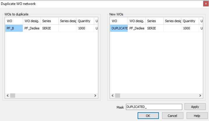

Duplicate WO network:
Sends an event to duplicate a whole WO network.
Fix WO supply:
Sends an event to force the supply of a WO as fixed/unfixed or to cancel the forced supply:

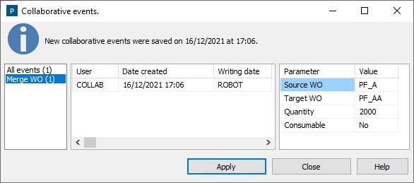

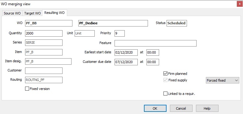

Merge WO:
Sends an event to merge 2 WOs into 1 single WO:
About collaborative mode
As usual with collab event, once validated they pop up on the planner Planning in the event manager
when the right option is activated.

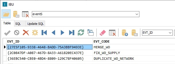

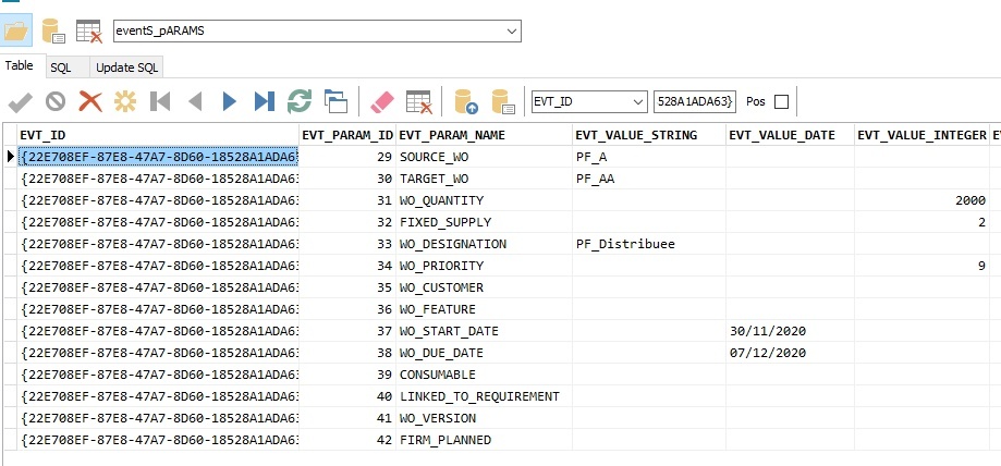

All the events are stored in EVENTS and EVENTS_PARAMS tables.
By taking a more in depth look at the tables, here is an overview of the 3 events in EVENTS table:
For instance, the “MERGE_WO” event has its related details stored in EVENTS_PARAMS as followed:
