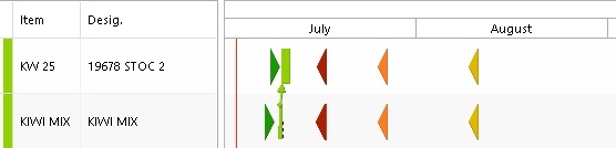

Depending on your product type, the shelf life can be either calculated based on planned production dates, or inherited from components / batches used for its own production.
In order to enhance your preferred decision making tool, we also added new display and alert systems.

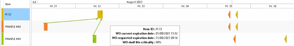

At WO level, 2 additional triangles to display WO requested expiration date (Orange) and WO current expiration date (Yellow).

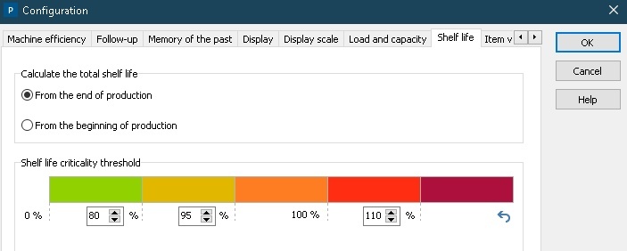

If you face any conflict you will have a new WO color to highlight the criticality of the shelf life including pre-alert system. 100% being a kind of risky just in time, below 100%, customer request is fulfilled, above 100, the planning doesn't match customer shelf life request.
Criticality color is selected here in WO Gantt Chart. Also the pop up/hint windows has been enriched with additional shelf life information

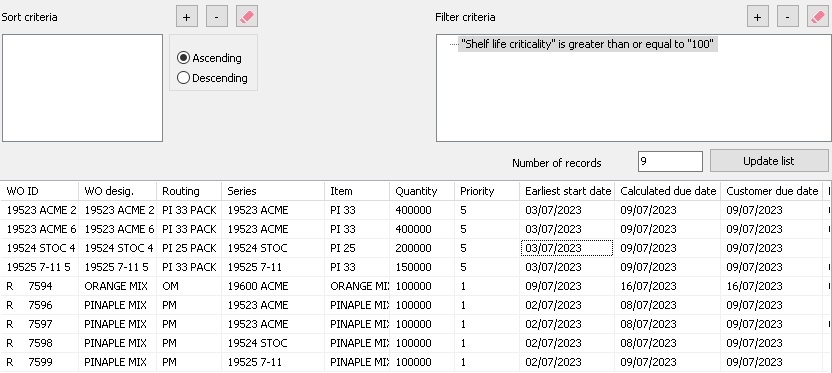

Based on the shelf life criticality, you can also easily create your own filter, select and highlight for example the expired Process Orders (crit.>100%):
