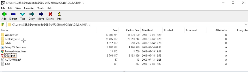

Download the DSLS license Server setup file
  • Navigate to https://software.3ds.com/
  • Then click on 3DEXPERIENCE and V6
  • From this screen, choose: “3DEXPERIENCE R2019x” Release and “3DEXPERIENCE R2019x Golden” level and find the following in the list:
  • Download the file
Install your DSLS Server
All instructions are located within the zip file you just downloaded.
  • Extract all to hard-drive
  • Open the DSLS.pdf file and follow the steps

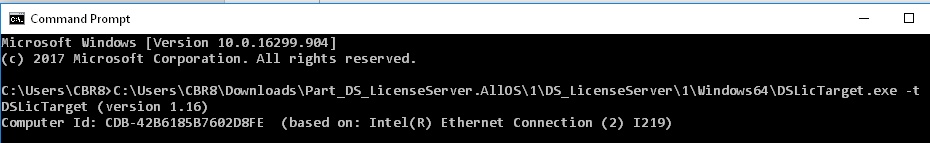

Computer ID
There are two ways to identify the Computer ID:
  • Open the software “License Administration Tool(By default: C:\\Program Files\\Dassault Systemes\\DS License Server)
This “Computer ID” is located on the “Server Definitions” tab
Or
  • launch the software DSLicTarget.exe using the command prompt and add –t at the end.
This software is located on the zip file at the following path (xxx\\Part_DS_LicenseServer.AllOS\\1\\DS_LicenseServer\\1\\Windows64)

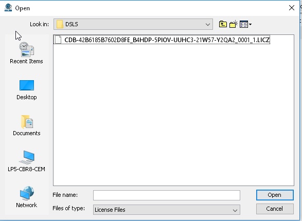

Installation of the license key file
Concerning the installation, you need to:
  • Open the software “License Administration Tool” (License Server Administration), ensure that the status of your server is “Connected” otherwise Right Click and Connect it.
  • Click on the License menu and Enroll
  • Select the file you received from the KMC team (LICZ extension)
NOTE be careful where have saved the file, the screen shot below shows a file path that is normally rights restricted

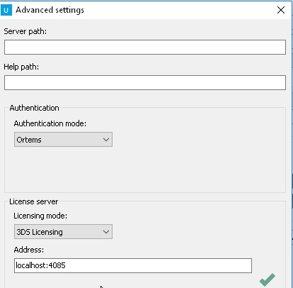

Configuration of DELMIA Ortems to switch on DSLS license keys
  • Open the DELMIA Ortems “Environment management” module
  • Navigate to Administration > Advanced settings (formerly Advanced Parameters in the menu, to be changed in future releases) menu
  • Change the Licensing mode to 3DS Licensing

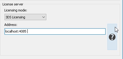

Enter in the Address path field, the name of the license server (or its IP address) followed by “:4085” (here the example is for a local installation, not for a license server that will serve other computers, then we entered "localhost").
Click on the test license server button to check your installation.
