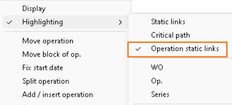

What does “Highlighting > Operation static links” do?
“Highlighting > Operation static links” highlights only the operations directly linked to the selected operation (whatever the links are originating from and arriving at the selected operation). This differs from “Highlighting > Static links” that propagates the highlight to the successors of the successors of the selected operation.
Key point: Associated with the option “Highlighting > Add to list”, this highlight allows the user to better control how the network of highlighted operations will expand.

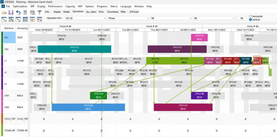

“Highlighting > Static links” from the operation in the orange rectangle results in the following network of operations:

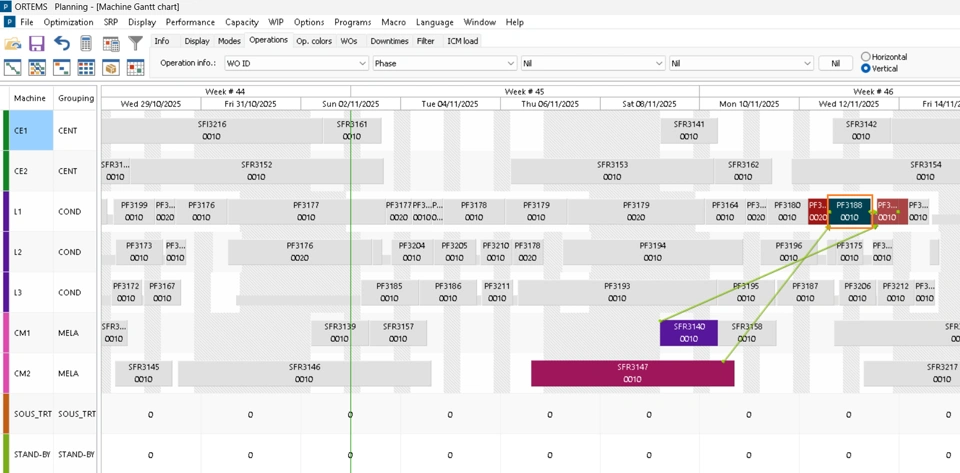

“Highlighting > Operation static links” (when “Add to list” is not enabled) from the same operation in the orange rectangle results in the following network of operations:
After enabling “Highlighting > Add to list”, let us select another operation: the predecessor of our initial operation on the same machine (in the orange rectangle).
The plan now looks like this:
In a complex plan with many links, this new Highlighting mode is helpful to the user focusing on what matters.
