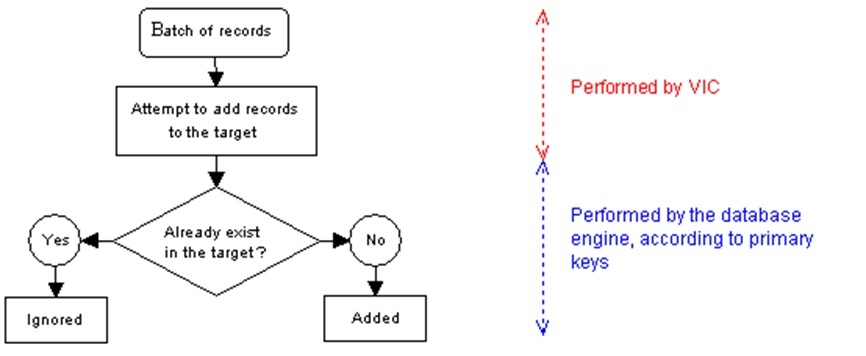

“Append_batches” mode description
“Append_batches” mode is very similar to “Append” mode except that it manages records in batches rather than individually.
This is the simplest and fastest interface synchronization mode that you can choose for database-type targets in the configuration database in VIC Editor.
It transfers the records in batches to the target database. The database engine then adds all the new records. It does not replace any existing record.
The default size of the batches is 1 000 records, but you can change that value in the Environment Management application for each environment (database) concerned, in the right panel, in “Advanced” tab. The ResourceOptions.ArrayDMLSize field displays the current batch size. You can modify that number.
The database engine relies on primary keys to identify the new records it must add, versus the existing records it must skip.
This synchronization mode generates "violation of primary key" messages each time there is an attempt to write to an existing record.
