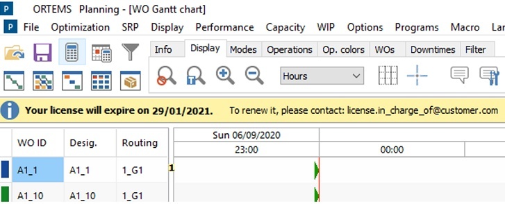

After the parameters have been set, once the license enters the period of warning described previously, the planning pops the following message to the users.
The message indicates the expiration date of the license and the contact information.
