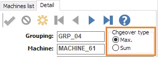

Previously in Ortems
Presently in Ortems
Only 1 setting at Machine level.
On the following screen-shot, on MACHINE_61, the rule is Maximum of all times (Tools, Discrete parameters and Continuous parameters):

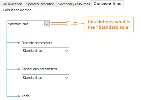

More detailed customization at Machine level.
As long as “Discrete parameters” and “Continuous parameters” rules are set to “Standard rule”, it runs as previously.
The following screen-shot offers the same behavior as the screen-shot on the left.
Note #1: what we call “Standard rule” is defined by the selection done for the first combo box.
Note #2: as only one tool can be assigned to an operation, there is no need to offer a formula for Tools.

The configuration to model these rules is as follows:
Note: Take care that separator between parameters to be used in formula is the semicolon character ‘;’ (for more details about syntax to use, refer to online help). Moreover, symbols (as ‘+’ to sum) are not interpreted as functions because parameter names can include such characters.
