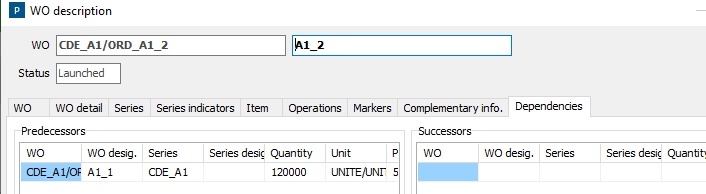

From a WO Gantt chart or WO focus Gantt chart, clicking in the left panel on a WO ID pops up the WO description with a new “Dependencies” tab showing the dependency links:

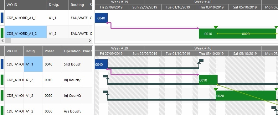

Why the positioning of the link change ?
The source and destination operations of a dependency link can vary over time, according to the changes brought to the plan, or to the progress of the WOs.
For instance, when fixing the starting date of the green 0020 operation to a later date.
The link is now established between the blue 0040 operation and the 0010 green one.
This is explained by the fact that the link is between 2 WOs and not between specific operations.

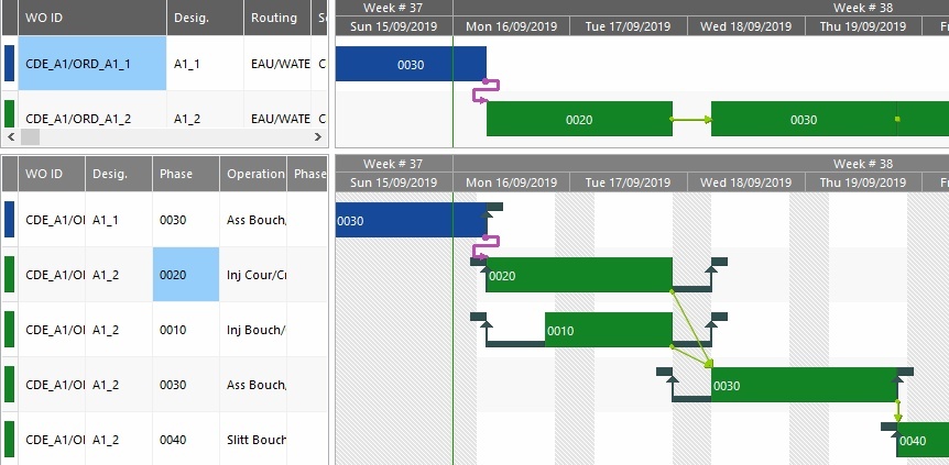

In the case of an operation deletion :
Starting back from the initial situation, what happens if the upstream or downstream operation of the link is deleted ?
In the below example, after blue 0040 operation has been deleted from the planning, then the planning creates a link between 0030 blue operation and 0020 green operation.

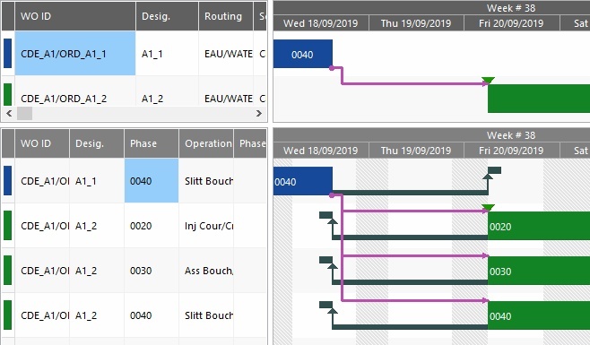

If a downstream WO has several start operations with one or several end operations from the upstream WO, for clarity sake, the application displays a single dependency link between the 2 WOs. The Dependency link is then displayed between the operation with the latest end date for the upstream WO and the operation with the earliest start date for the downstream WO.
To illustrate that point, in the below example, 0040 blue operation has total precedence link with 0010, 0020 and 0030 green operations: the dependency link is set between 0040 blue and 0030 green:

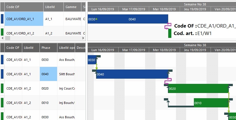

However, in case where all the operations of the downstream WO have the same start date, Gantt charts display then the link for each of them.
If now, the start date of the 0040 green operation changes by being fixed earlier, the dependency changes accordingly.
Namely, only the most constraining link between WOs is visible.
