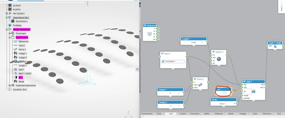

Can someone explain why when I do this simple example using spheres to cut the original surface that it does not remove the "holes"? I am using Mode=default and the original patch is hidden. I am using 2025X-FD05 for reference.

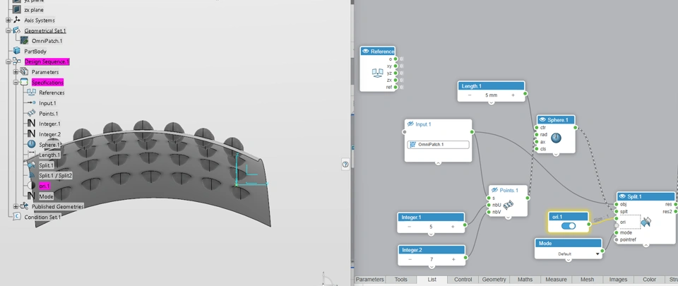

Spheres cut thru the surface OK:
If I switch Orig to off I get just the holes.
