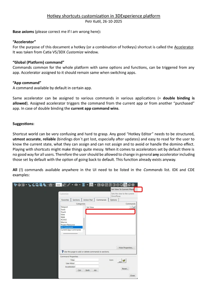

Hi all users and R&D!
As a reply to @Laurent IGARZA comment in the IDX WISH post by @Barry Hale I share my view on the shortcut customization topic in 3DX. It is a few pages text more about the interface than the actual hotkey maps. I enclose links to a pdf and two short videos. Please let me know if you think any of this could be useful for users and acceptable for R&D.
PDF:
Overview...:    A_US keyboard:
Overview...:    B_List of keys:
Please share any of your other thoughts, comments or facts I missed and correct me where I am wrong. It would help me to understand better and maybe provide more accurate input next time.
