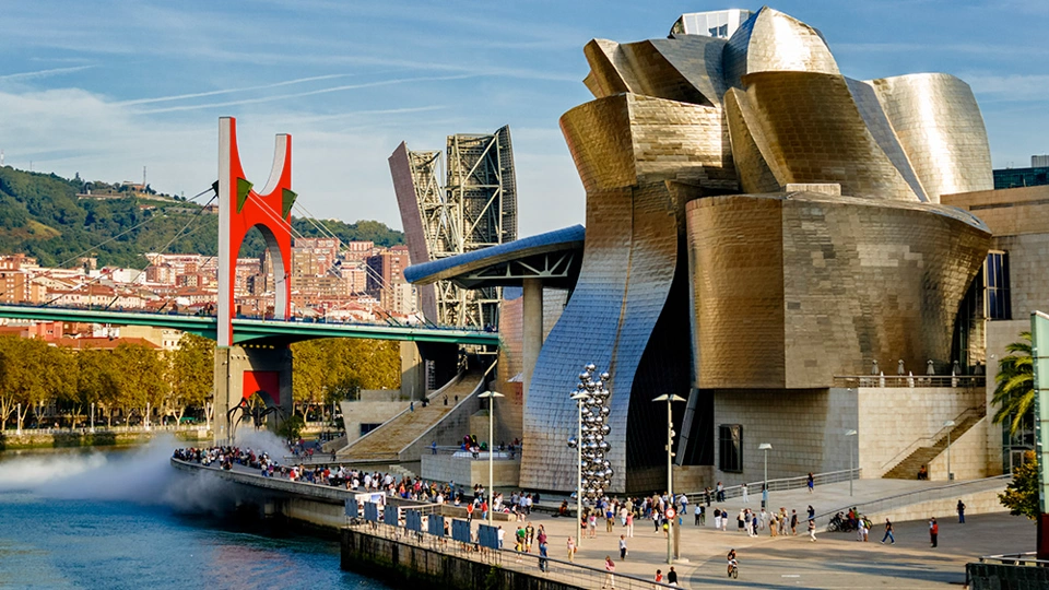

In the early 1990s, Bilbao was in trouble. Unemployment was high. Morale was low. And in this context, the local government proposed something extraordinary: to revive the city’s fortunes by building an art museum.
Not just any museum — a radical new structure that looked more like a sculpture than a building. With swooping titanium walls and impossible curves, many said it couldn’t be built. Others said it shouldn’t.

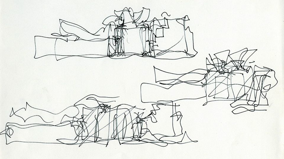

From hand sketches to paper models to digital simulations, Gehry’s team developed the Guggenheim’s design in a way no architectural project had been realized before. CATIA didn’t just describe the shape — it broke it down into thousands of parts, each of which could be manufactured and assembled with millimeter precision.
It also helped solve another puzzle: how to construct curved surfaces using flat materials. CATIA could “unfold” the building’s skin, providing 2D templates for each titanium panel — a task that would have taken teams of engineers weeks to complete by hand.
And it worked. The museum drew 1.3 million visitors in its first year — more than triple expectations. CNN covered the opening. International tourists arrived in droves. The local economy boomed.
