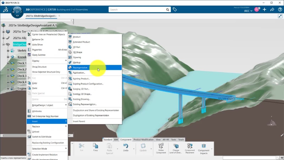

this week, I will share 2 videos. The first one explains how to prepare your bridge data for Simulation (abstract shape, mesh...) and how to integrate those preparation item in your engineering template so that they are automatically instantiated with your design. Thus you will save a lot of preparation time when you will run your Simulation, because your deck will already contain the simulation representation in addition to the design one.

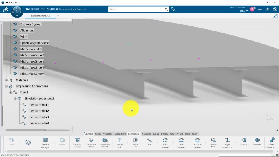

Second one shows the end to end process from Design to Simulation (ModSim) on a simple load case.
