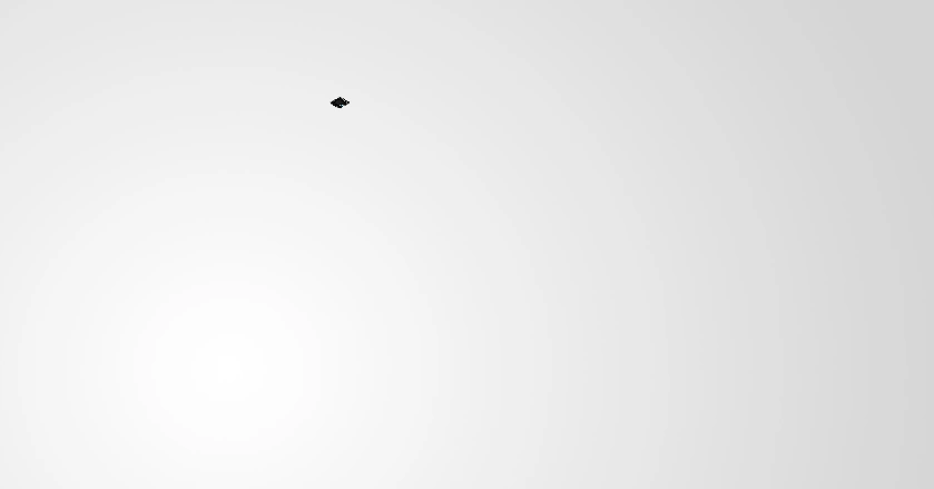

When we import geometry which contains surfaces, there are chance that very small faces remains and you might not realize its presence. Your effort solidify fails or you might see that model is so much zoomed out when you are in isometric view. See image below.

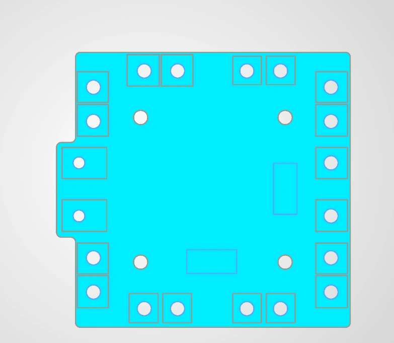

1) simply zoom to your 3d model and go in Top View.
2) Select all the surfaces in top view.
3) Right click in graphics area and go to "Selection Tools" > "Invert Selection".
4) Now click "Delete" from keyboard and "Delete/keep Body" operation will appear. Since the surface would be existing independently, it would be treated as separate body. "delete Face" won't work.
5) You will see that surface/s will be selected in the property manager. Executed the command and those bodies will be deleted.
