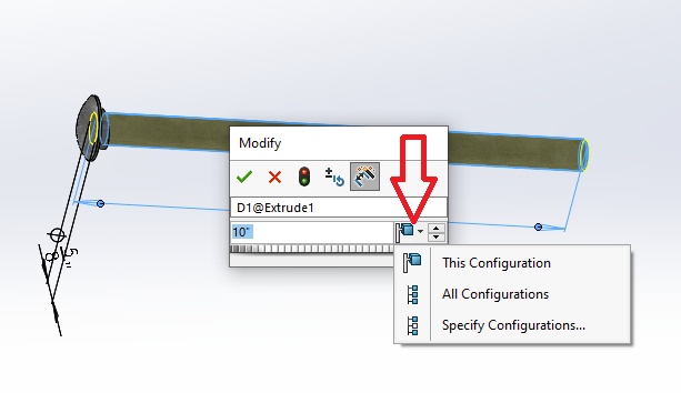

1. One way is to open the standard dimension dialog box for the value, click on the Configuration icon, and make the appropriate choice. If you do this outside of an active sketch then you'll probably need a manual rebuild for the change to take affect.

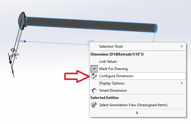

2. Many people use that method, but I prefer another workflow that doesn't require me to be in "Edit sketch" or "Edit feature" mode. In fact, it only works when there isn't a feature or sketch active. I single-click on the feature or sketch in the tree to display the values. (If you don't have Instant 3d turned on then you'll need to double-click on the feature, or go to Annotations at the top of the tree and choose "Show feature dimensions".) I then right-click on the dimension in the graphics area and choose "Configure Dimension" from the drop-down.

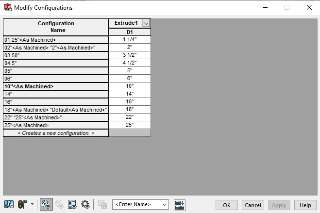

This will open up a simplified design table, with a column for the configuration names and one for the selected value, and a row for each configuration. You can enter the desired value in the appropriate cell for each configuration in this table.
While this table is open you can double-click on other dimensions, sketches, or features to add columns. If you double-click on a sketch there will be a drop-down where you can select sketch dimensions to add. If you will have multiple columns I'd suggest naming the sketches, dimensions, and features, so you can easier keep track of them.
As you can see in the cell below the last configuration name, you can also create new configurations from this table. I often use this method to create new configurations instead of going to the configurations tab and adding them there.
If you'll enter a name for the table at the bottom you can save it for future edits, but the changes you make in this table will still be saved even if you don't save the table. And as I said above, after closing this table you've effectively "told" SW that this dimension is configuration specific, so if you want to edit the dimension later you don't need to re-open the table. You can just click on the feature to show the value in the graphics area again, click on it, and change it to the new value. That change will only affect the active configuration, and won't require a rebuild for it to take effect.
