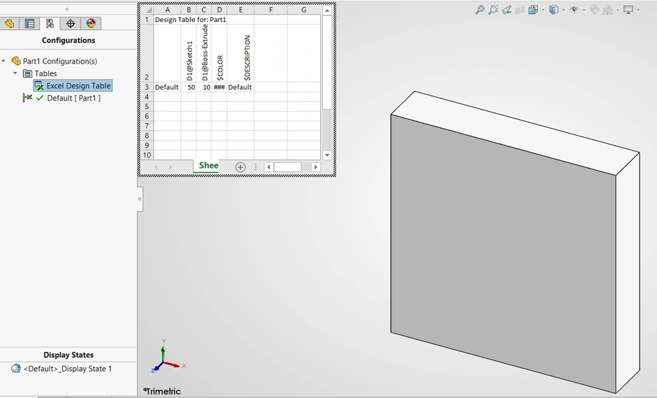

  1. Create a design table using "Auto-Create" option. For this, I have considered simple square plate. So I have 2 parameters here sketch dimensions and its thickness as Boss Extrude.

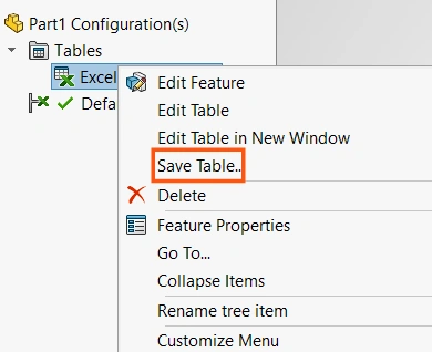

    2. Exit the design table window by clicking anywhere in graphics window. Then right click on "Excel Design Table" and Click on "Save Table". Save it anywhere on your disk.

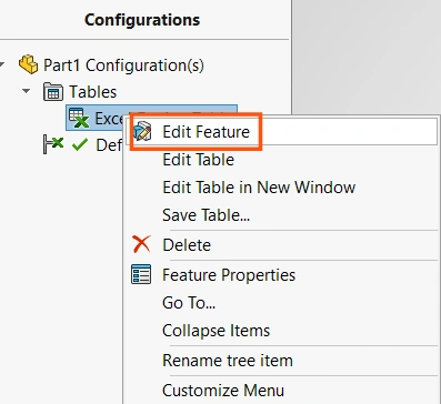

    3. Once it is saved. Go back to "Configurations" property manager -> Right click on "Excel Design Table" again and click on "Edit Feature".
    4. In the first step, you used "Auto-Create" option. This time click on "From File" and browse to the location where you saved the excel file. The most important step is to check "Link to File" dialog box.
