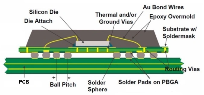

e) Electronic packages and primary heat path
Figure 2: Typical plastic ball grid array package
Figure 3: Primary heat path in PBGA
As an example, consider a single-chip plastic ball grid array (PBGA) package on the PCB board of a device (Figure 2). The primary heat transfer paths for this package are shown in Figure 3. Basically, there are two main heat dissipation paths from the silicon die. These are 1) to the case of the package (upward), and 2) through the PBGA and into the PCB (downward). Heat from the case and board then passes to the skin of the device for convection to the ambient environment.
The PBGA package consists of a silicon die (chip), which is mounted on the substrate using a die attach (thermally conducting adhesive). The package substrate is a multilayer printed circuit board with metal circuit traces and through holes (routing vias) to connect the front of the laminate with the ball pads on the back side. On the top surface of the substrate, there are metal pads to which the gold wires bond. The pads on the semiconductor chip are arranged around the perimeter allowing for ease in wire bonding from the chip to the pads on the substrate. This entire integrated circuit and gold wire bond are encapsulated in a plastic mold, shown as the epoxy overmold in Figure 2.

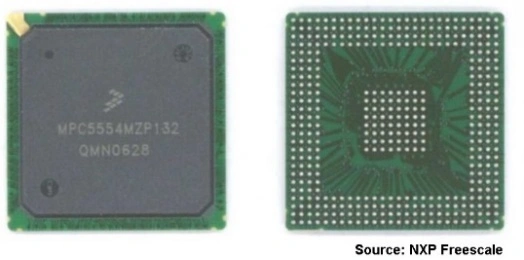

Figure 4: Typical PBGA Top Bottom Photo (416 Pin, 1.0 mm Pitch, 27 X 27 mm sq.)
The solder spheres (or balls) connect the semiconductor substrate with the PCB or motherboard. In practice, the PBGA manufacturers place the solder balls on the bottom surface of the substrate and ship to the customer. Customers then mount PBGA on the printed circuit board or motherboard for final use.

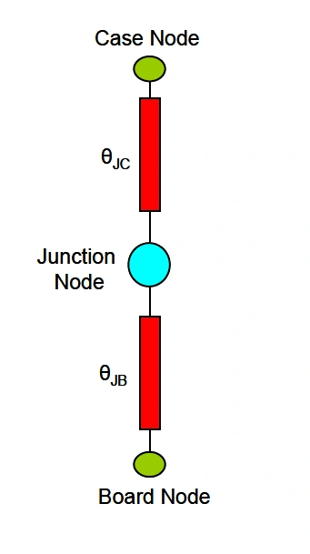

c) Two-resistor compact model
The two-resistor compact model consists of three nodes connected by two thermal resistors. These three nodes represent the measured values of the Junction-Board (⊖JB) and Junction-Case (⊖JC) resistance shown in Figure 5.
In other words, in this type of CTM, the heat leaving path is identical to the primary heat transfer path as shown in Figure 3. However, this does not account for heat leaving or transfer through the side of package is not accounted.
Figure 5: Two-resistor model (Reference - https://www.jedec.org)

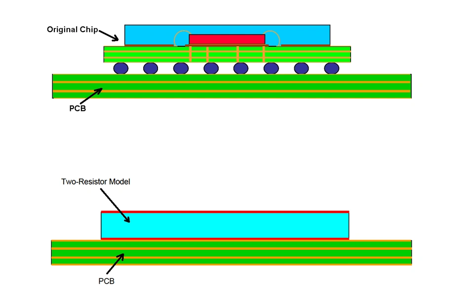

Therefore, in a two-resistor model, instead of considering the exact geometry package (chip), the model is considered to consist of three nodes:
  • The junction is considered as a high conductivity solid plate with heat-insulating side walls. Only the top and bottom surfaces can exchange heat with the environment.
  • The board is considered to be in direct thermal contact with the local environment immediately below the footprint of the package. This is normally the printed circuit board (PCB).
  • The case is considered to be in direct thermal contact with the local environment immediately above the top of the package. This is normally air or a thermal interface material used in conjunction with a heat sink.

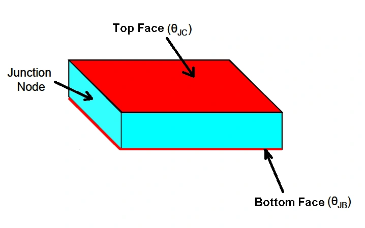

A two-resistor component is created by selecting at least one face of the component as a Top Face as shown in Figure 6. The software considers this as the case node and the Bottom surface as the board node automatically. The top and bottom surfaces of the geometry or component must be parallel to each other (For a detailed step-by-step method, refer to QA Article, QA00000111009).
Figure 6: Creating two-resistor component
For an example, Figure 7 illustrates placement of a single package on the PCB and the equivalent two-resistor model (image source: “Two-Resistor Compact Model Guideline”, JESD15-3).
Figure 7: Creating a two-resistor component

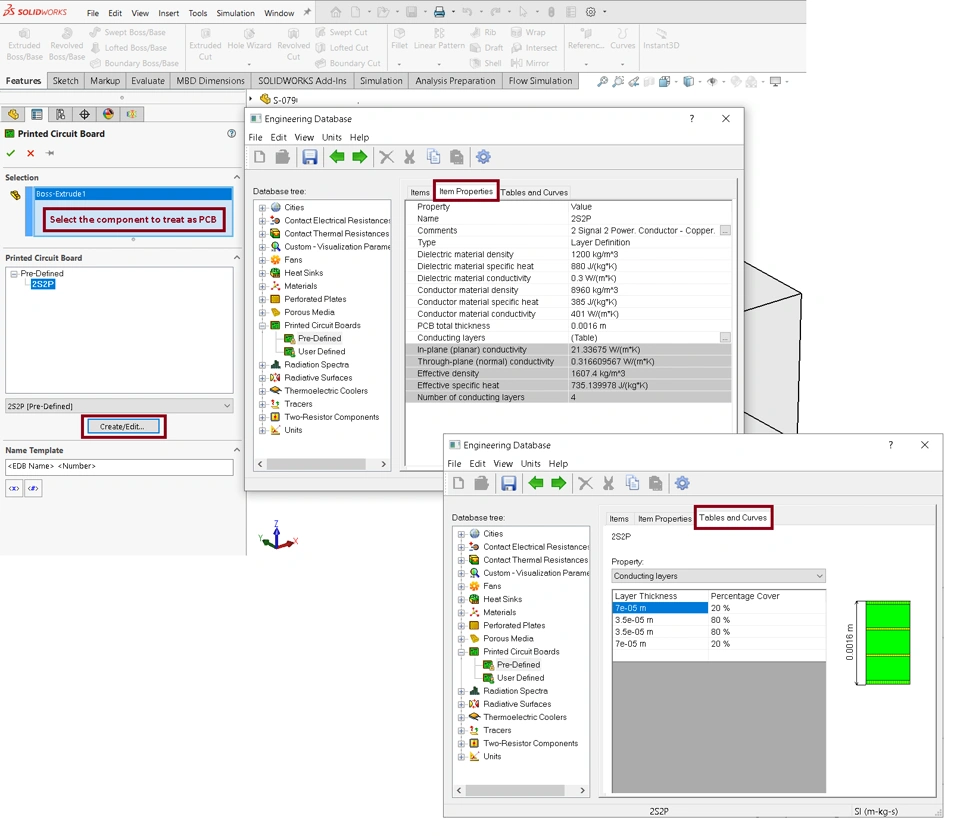

e) Printed circuit board (PCB)
A printed circuit board (PCB) manufactured from FR-4 material mechanically supports and electrically connects electrical or electronic components using conductive tracks, pads and other features fixed from one or more sheet layers of copper laminated onto or between sheet layers of a non-conductive substrate. Modeling the actual PCB along with its detailed copper traces, vias (to pass connections between layers of copper) is challenging, time-consuming and not desirable. In SOLIDWORKS Flow Simulation ECM, users can pick the predefined PCB to replace the actual component in the graphics area (see Figure 8).
Figure 8: User interface & dialog box, defining Printed Circuit Board
Users also need to define density (ρ), specific heat (C), and thermal conductivity (K) for both dielectric (denoted by D index) and conductor materials (denoted by C index) of the PCB.
In addition, users must describe the internal structure of the PCB in one of the available types, namely Conductor Volume Fraction, Board Mass and Layer Definition. For more information, see the Knowledge Base QA Article: QA00000116176 or refer to the topic “Creating a Printed Circuit Board” in the “SOLIDWORKS Flow Simulation Online User’s Guide”.
For the Layer Definition type, specify the PCB total thickness and the number of conducting layers (in the Tables and Curves tab). Additionally, each conducting layer user input is required for the Percentage Cover (the volume fraction of conductor material in the layer, for more information read QA00000114220) and the Layer Thickness.
Figure 9: Cross section of 2s2p PCB showing trace and dielectric thicknesses
For example, Figure 9 (Reference: https://www.jedec.org/system/files/docs/JESD51-9.pdf) shows the typical cross section of a four layer PCB. Two layers are dedicated as power supply and ground planes, and the other two layers are used for signal wiring between components. This is commonly known as a 2s2p board, displaying trace and dielectric thicknesses.
The generated PCB possesses the equivalent anisotropic thermal conductivity based upon all of these input (and as per the modeling specifications from the JEDEC standards).
For a detailed technical explanation of a Printed Circuit Board in SOLIDWORKS® Flow Simulation software, refer to QA Article QA00000116176
