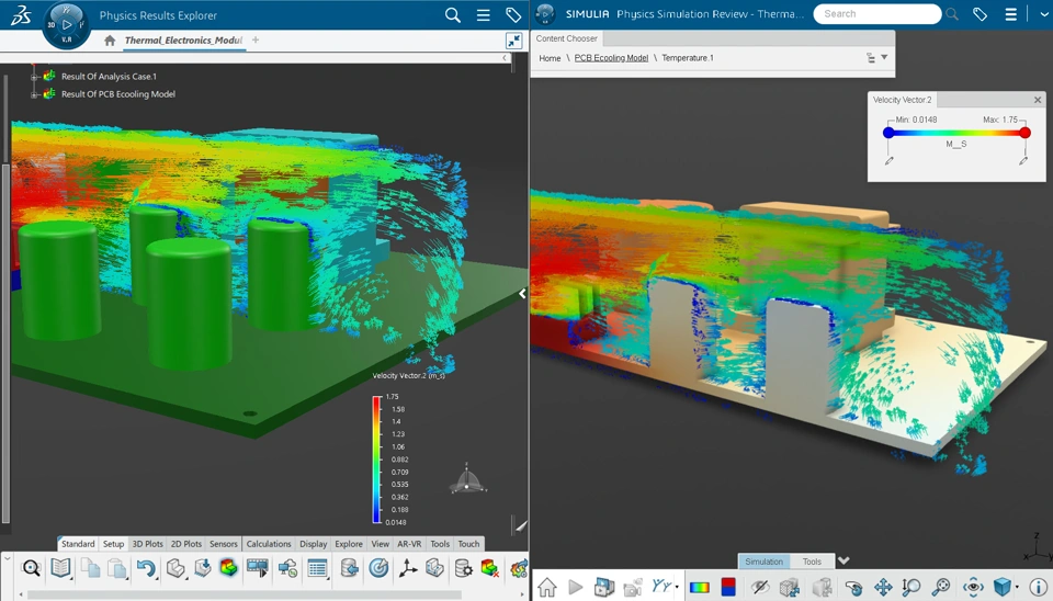

Multiple Simultaneous Legends in Results Viewer
Display multiple result legends at the same time in the Post-processing and Simulation Review app when working with scenes, slices, streamlines, or isosurfaces that each require their own legend. Compare results across multiple active plots without switching between single-legend views.

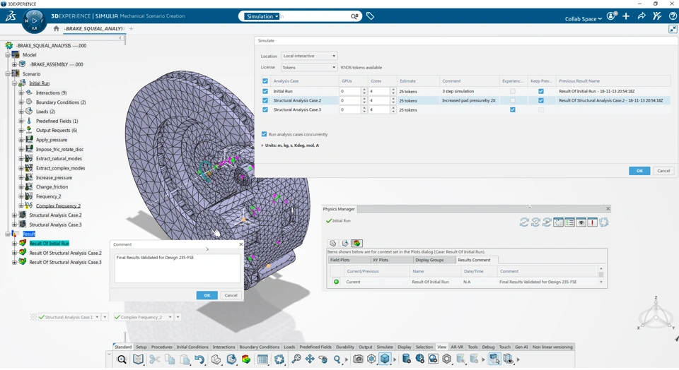

Results Management
Name and comment on analysis results to keep your work organized and easier to review.
