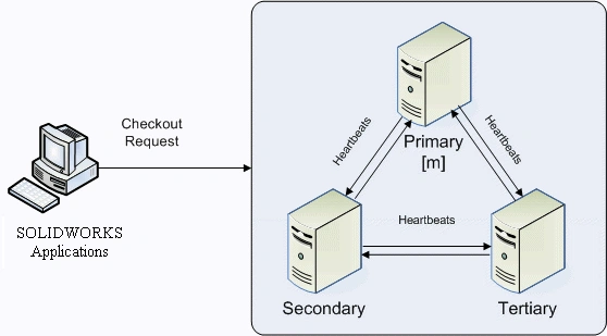

  • Triad Server
The limitation of a single server SNL setup is that when the license server fails, the licenses are not available to clients. A triad server setup helps to minimize down time because of server failure. The advantage of using a triad server setup is that clients will get the license even if one of the triad server computers is unavailable.
  • The triad server environment contains three server computers.
  • It is a best practice to connect the three license server computers via the LAN and on the same subnet. All three servers send periodic messages to each other to ensure that at least two servers are running and communicating at any given time.
  • Triad server SNL uses license file based licensing.
The following images depict a pictorial representation of a working triad.
Figure 1: Client fetching license when three triad servers are running
Figure 2: Client still gets license when one of the triad servers is down

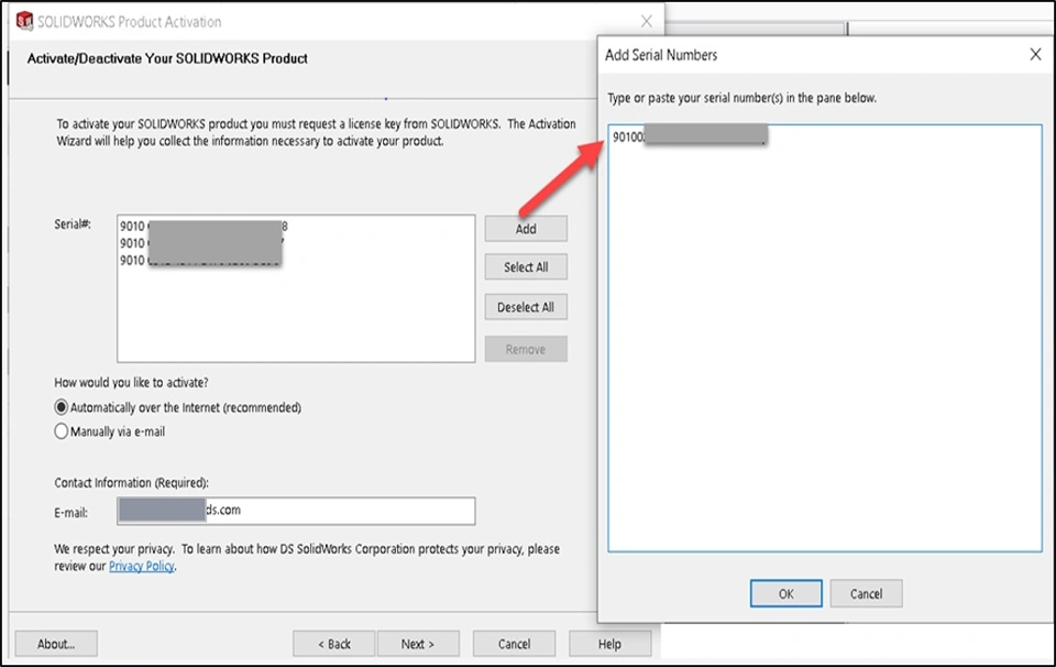

  • Add Serial Numbers: Starting from SOLIDWORKS 2023, CAD Admins can add a new serial number while Activating/Reactivating the existing Serial Numbers. (see Figure 7).
Figure 7: Add Serial Numbers Window

When implementing global licensing, the recommendation is to use a Triad license or a similar redundant solution. For other possible workarounds, you may contact your reseller and refer to the QA Article QA00000110503. Using a Triad or similar solution, you can set up servers in specific countries or regions with other servers to provide backup licensing servers.
During initial license check out, clients ping all servers that appear on the Server List tab of their SNL Manager. However, subsequent checks ping the server from which the license was checked out. To ensure maximum performance, the recommendation is that users enter their local server first in the list. Licenses pulled from non-local servers experience slightly slower overall performance because of the longer ping times between the client and server for rechecks.
Use of a Triad requires additional considerations, which are discussed in the SNL Types section of this document.

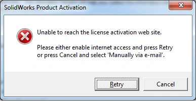

ii) Unable to reach the license activation web site
During the automatic activation or deactivation of a license, users sometimes receive the warning Unable to reach the license activation web site.
Figure 15
This error appears in the following cases:
  • The computer does not have an internet connection.
  • The computer has an internet connection but the activation server site is not available. This can happen if there is a problem with the firewall or proxy server settings.
  • The activation server is offline for maintenance. Maintenance work typically occurs on weekends. SOLIDWORKS notifies resellers in advance of upcoming maintenance.
Troubleshooting steps:
  1. Run a ping test to confirm connectivity with the activation server.
  2. Paste the following link into the address bar of your web browser and press Enter.
https://activate.SOLIDWORKS.com/activation.asp?ping=1
  • If the web page appears blank, it indicates that there is proper connectivity between the computer and the activation server. In such cases, the user is able to perform an automatic activation.
  • If the web page displays the warning Page could not be displayed, it means that the computer cannot access the activation server. This commonly occurs because of a problem with the customer’s network setup. In these cases, it is advisable to work with the customers IT representative to resolve the issue.

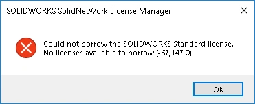

ii) Borrow license issues
  1. Cannot borrow license
Figure 17
The error Could not borrow the [license]… appears when there are no licenses available to borrow. This can happen if:
The product license that the user is borrowing has reached its maximum usage count. For example, if a customer has two SOLIDWORKS Professional licenses and both are in use by two users. At the same time, if third user tries to borrow a SOLIDWORKS Professional license, SOLIDWORKS displays the error message shown in Figure 16.
The administrator has set the BORROW_LOWWATER option in the options file. For more information, refer to the “licensingenduserguide.pdf” document.

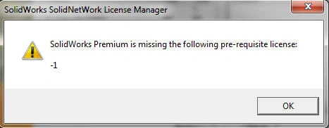

2. SOLIDWORKS is missing the following pre-requisite license
Figure 18
SOLIDWORKS displays this warning message if a prerequisite license is missing when borrowing a SOLIDWORKS Professional or SOLIDWORKS Premium license. For more information about this warning message, see the QA Article QA00000115392.
