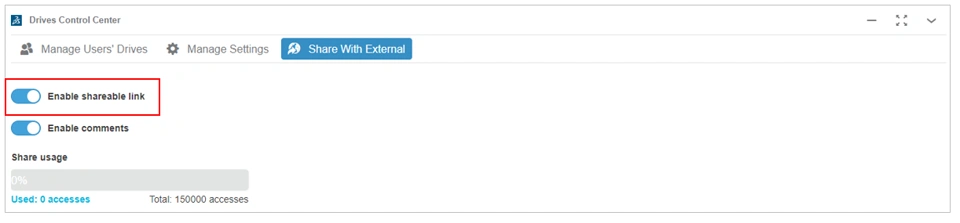

To allow users to share files, first the platform administrator must enable the Enable Shareable Link option located on the Share with External tab in Drives Control Center.

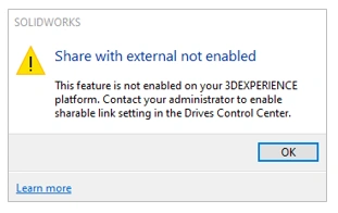

If this option is not enabled, the following message will be displayed when selecting the Share a File command in SOLIDWORKS.
To allow recipients to share comments, the Enable Comments option must be switched on. If this option is off then the option to enable comments will also be missing from the Share a File command in SOLIDWORKS.

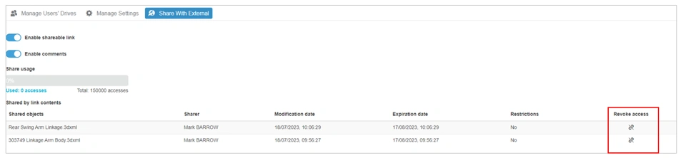

The platform administrator can track what files have been shared and with who using the Share with External tab in the Drives Control Center widget. If required the platform administrator can revoke access to any one or more of the shared files before it's expiration date. This may be necessary if a user has inadvertently shared a file that must not be accessible to external stakeholders.

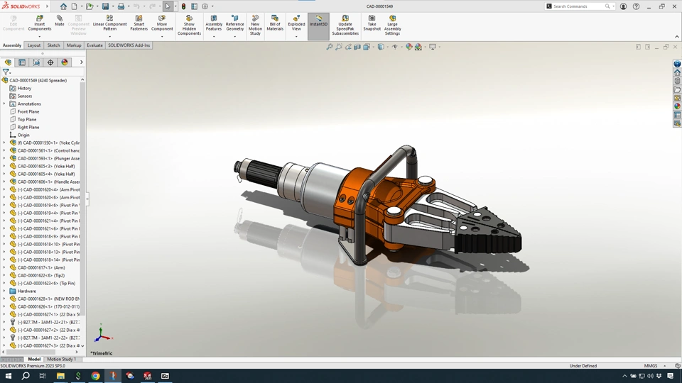

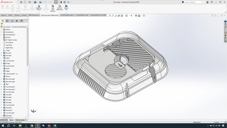

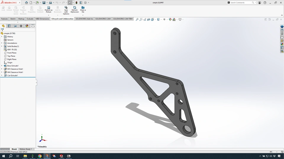

The table below highlights the file size (MB) of 3DXML in comparison with the alternative file format options available in the Share a File command.
Simple Part ModelSmoke Detector Cover (Complex Part)Structure System (Weldment Part)Holmatro AssemblyMitre Saw AssemblySquare Robot Assembly
