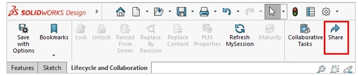

Share and Markup provides users with the ability to share their 3D designs with anyone, directly from SOLIDWORKS Design using the “Share” command on the Lifecycle and Collaboration tab.
The Share command is available to anyone using the SOLIDWORKS Design roles and the Collaborative Designer for SOLIDWORKS role. However, the recipient of a file does not require any 3DEXPERIENCE role or SOLIDWORKS license to view, markup and share comments with the person who shared the design. This method removes the friction associated with traditional design sharing and collaboration tools.
The Collaborative Designer for SOLIDWORKS role is available to SOLIDWORKS Design users via their SOLIDWORKS Subscription with Cloud Services, making design collaboration available to a wide range of users, including those who may be using SOLIDWORKS PDM or the Windows file system for managing their designs.
