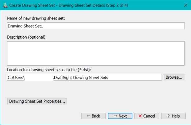

  1. Type command SheetSet in DraftSight command window :This will activate Sheet Set Manager wizard in DraftSight task pane
  2. Click on option New Drawing Sheet Set (You can either use an existing Sheet Set file (.dst) as a template, or simply choose some existing drawings)
  3.  Specify suitable name for your sheet set and location to save it and click Next.
  4. Browse to folder containing .dwg files that you want to add in this sheet in next window or keep it empty at this point and proceed.

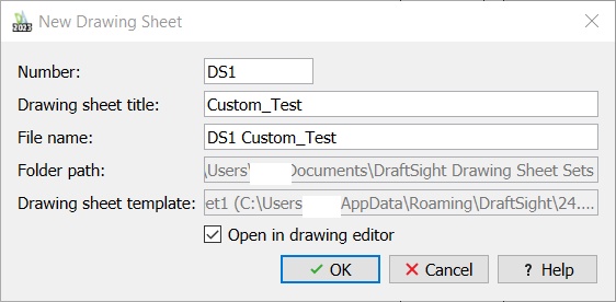

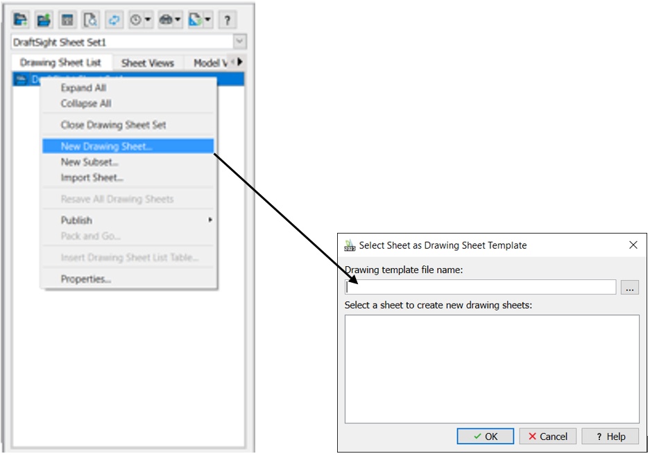

    • Now you can see your sheet set has been create successfully. Select the created sheet set>right click and choose New Drawing Sheet to create new drawing sheet from a custom template.
  5. After specifying correct template to use in new sheet, click next and specify sheet details according to your company standard or project requirements.(Enable ‘Open in drawing editor’ to open sheet automatically in DraftSight after its creation)

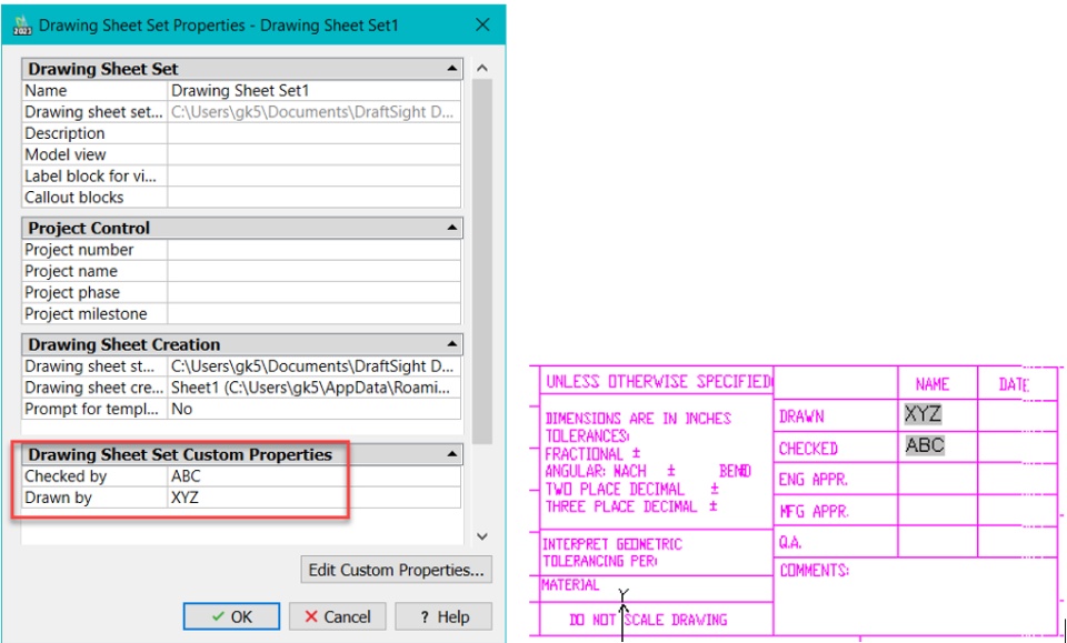

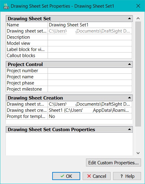

  6. Right click on Sheet set ‘DraftSight Sheet Set1’ from task pane>Properties. This will open Drawing Sheet Set Properties window.The Drawing Sheet Set properties includes information about the drawing sheet set data file (.dst), drawing sheet creation template, and custom properties associated with the drawing sheet set. The properties are grouped in the following categories. We can fill this information as per our requirement and it will be used for all the sheets created under this sheet set. This way we can ensure that our project uses standard template, custom properties and project information. For more details about it refer DraftSight help: https://help.solidworks.com/2023/english/DraftSight/ssm/ssm_sheet_properties.htm

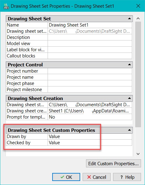

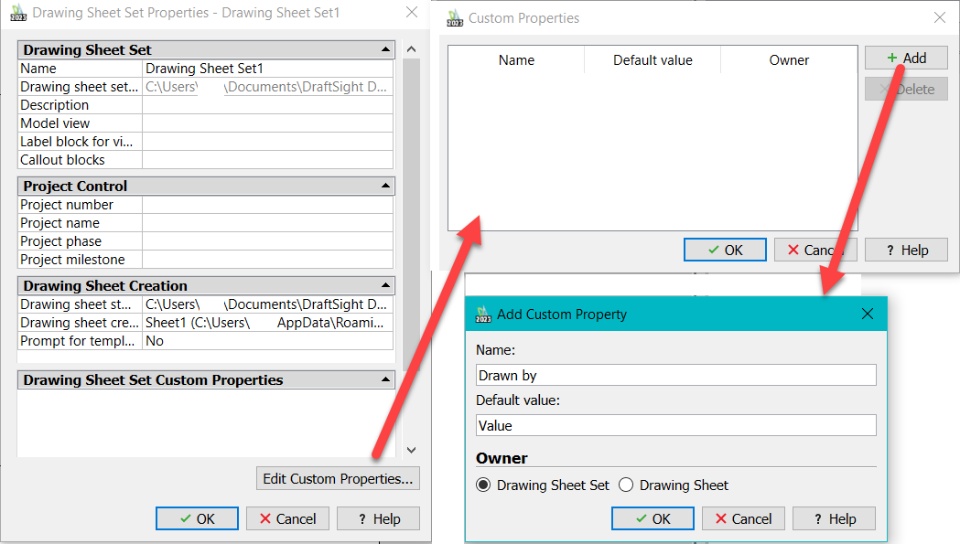

  7. Click on ‘Edit Custom Properties’ and add custom properties needed from the project.There are 2 types of properties can be added:
    • Drawing Sheet Set: User-defined custom properties associated with the drawing sheet set.
    • Drawing Sheet: User-defined custom properties associated with each sheet in the drawing sheet set.
      Here I created 2 custom properties for drawing sheet as below:Now we can access these properties in Fields in a new a sheet used for creating sheet set as below:

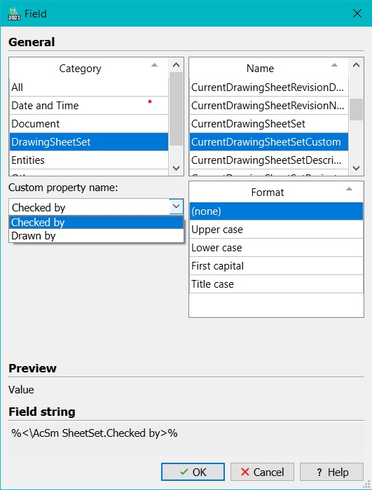

  8. In a sheet (which is already open in DraftSight after step5) type command Field. In Field window >Category select DrawingSheetSet and under Name click CurrentDrawingSheetCustom as below and we will notice custom properties that we created in step7.
  9. Insert these properties one by one for relevant attributes in title block so that their values will be linked to these fields.
Now if we update values of these properties from Sheet Set Manager, their values will automatically update in title block.
By creating title blocks in Sheet Set Manager using above method we can update the information in our sheets at any time without even opening a drawings. Thus we can save lot of time and avoid mistakes that can occur while working on larger projects.

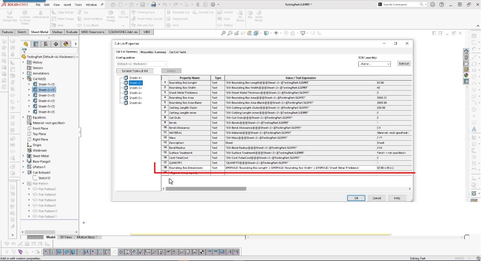

Problem Definition: Sometimes users want to create cut list properties and propagate these properties to some or all of the other cut list folders. However, there isn’t an intuitive way of doing this. In this video, I have demonstrated the two methods to achieve this :
  1. Propagate the New Cut List Property to all folders.
  2. Use the “Property Tab Builder” to Propagate to Selected Folders

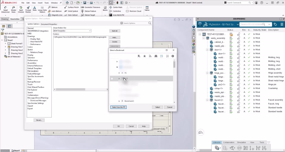

With R2023x FD03 enhancements, the addition of bookmarks on the platform as file locations to access SOLIDWORKS documents like sheet formats, BOM templates, sheet metal bend tables, weldment cut list tables, revision table templates, appearances, and many more is made possible for 3DEXPERIENCE® users.
The incorporation of bookmarks as file locations can facilitate the sharing and accessibility of documents by users.
Below is a short workflow that involves the uploading and addition of a BOM template to the bookmarks, and the subsequent inclusion of it in the file locations within SOLIDWORKS. A similar workflow can be employed for the addition of other folders as well.
Once the file location is introduced to SOLIDWORKS, a local folder is created in the system. This folder is situated under the path C:\\Users\\Public\\Documents\\SOLIDWORKS\\.
In the System Options > File locations tab, the Update tool can be utilized for the management of the local content downloaded from a bookmark. The Update dialogue box is comprised of options such as Check All, Update, and Purge. These options offer assistance with the following:
  1. Check All: This option aids in the quick selection of all the folders to verify whether they are Out of Date.
  2. Purge: The locally created folder at the file location mentioned above is deleted using this option. However, it is important to note that it will not remove the bookmark location added in the file location.
  3. Update: This option is designed to check and update the data in the selected folders with the data available in the bookmarks on the platform.
