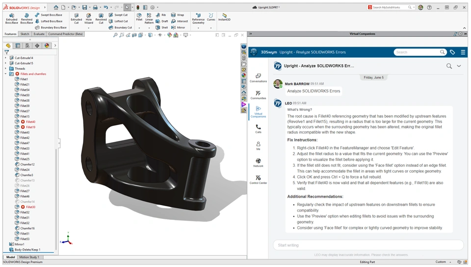

As this capability requires an error, in this example, we will force a modelling issue. If your design already has an error, then skip this first step.
Modify a dimension or redefine a geometric feature of a part model.
If that feature or any related feature cannot be rebuilt correctly after applying the change, a warning message is displayed. The warning message will state which features have failed and offer 2 options: Continue or Stop and Repair.
Selecting the Stop and Repair option will display the What's Wrong dialogue box. This displays a list of all of the affected features that cannot be successfully rebuilt.
To use LEO to provide deeper insight into how to resolve the issue, select the "Ask Virtual Companion" button on the What's Wrong Dialogue.
A new LEO conversation will be automatically started in the Task Pane. LEO will explain the root cause, provide instructions on how to fix the issues, and offer additional recommendations on how to avoid a similar issue occurring in the future.
