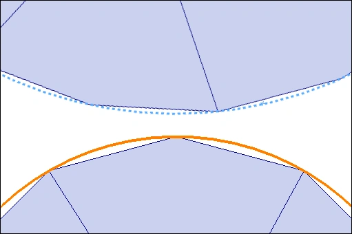

When you mesh a model in SOLIDWORKS® Simulation, the output is an approximate (tessellated) representation of CAD geometry. The image below shows an exaggeratedly coarse mesh to make this more obvious:
When you subsequently run a SOLIDWORKS Simulation study, the solver uses the meshed representation of the model for its calculations… not the original CAD geometry representation. If your study includes interactions like Bonded (meshed independently), Contact, or Virtual Wall, the solver creates special relationships between portions of the mesh to enforce those interactions.
To create these relationships, the solver must calculate distances between mesh element faces and/or nodes. One reason it does this is to properly consider user-defined values of Gap range for bonding or Gap range to consider contact when forming interactions.
The out-of-the-box default value usually ends up being a small (but non-zero) value relative to the dimensions of the model. You should always check the Gap range value because in many cases it requires adjustment to get the study to behave how you want. For a Bonded Interaction, it should be just large enough to comfortably bond what you want, but not so large that it bonds too much. The same concept applies to Contact Interactions.
An important point to keep in mind is that as a general rule, you should use a slightly larger value than the size of the geometry-based gap that you wish to include. If the largest gap you want to bond measures 20mm in your CAD model, to ensure proper enforcement of this bond, use a gap range slightly larger than 20mm, in most cases probably somewhere between 20.0001 and 22mm. To verify the areas of interactions (such as Bonded, Contact, Free, etc.), use the Interaction Viewer, ideally before you run your study.

This is necessary because the solver implements the interactions based on coordinates of the mesh, not based on coordinates of the CAD geometry. This point bears repeating, so to put it another (somewhat dramatic) way: the solver is oblivious to CAD geometry measurements. Because the mesh is a tessellated representation of the geometry, the precise distance calculated between mesh coordinates depends on many factors including the element size, orientation/alignment, curvature, the type of element (draft or high quality), etc.

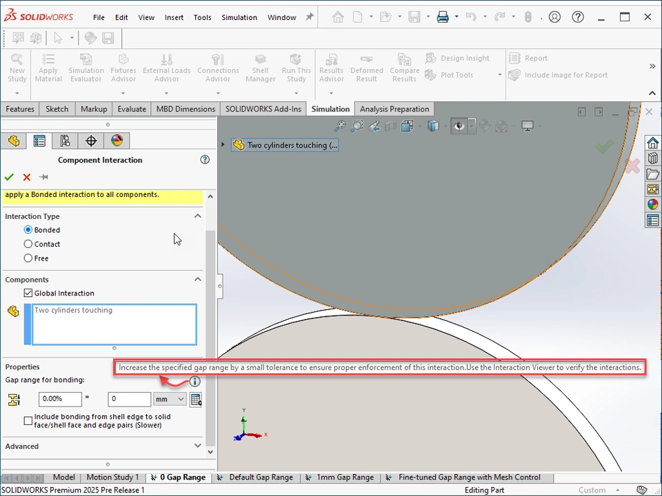

Consider a simple model with two touching (coincident/tangent) cylindrical faces. The top body has a small prescribed displacement to pull it up, and the bottom body has a fixed restraint.

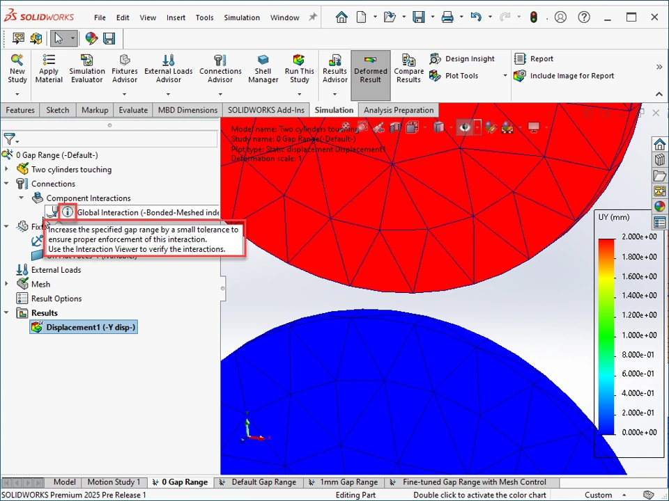

Let’s see what happens if we define a 0mm Gap range for bonding. Notice a message in an information ⓘ tooltip with text:
Increase the specified gap range by a small tolerance to ensure proper enforcement of this interaction. Use the Interaction Viewer to verify the interactions.
This tooltip message is one of the User Interface (UI) improvements that the R&D team implemented in SOLIDWORKS Simulation 2024 to raise awareness of this behavior and to provide appropriate guidance.
The classic mistake here is to think that because the minimum distance between these two bodies is 0.000000mm in the CAD geometry, a Gap range for bonding of value of exactly 0mm will always produce the expected bond. As explained earlier, the solver may evaluate that the distance between the mesh element faces/nodes is not exactly zero. It may be a small value (non-zero) value instead. This is especially likely for (though not unique to) curved geometry.
Running this study and subsequently viewing a displacement plot confirms that the bodies did not get bonded.
Notice
Information tooltip appears next to the left of the Interaction name in the study tree. The tooltip in the study tree appears only for 0mm gap range values, while the tooltip inside interaction PropertyManagers always appears – more on the reasoning for that later.

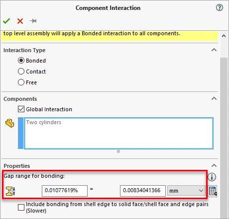

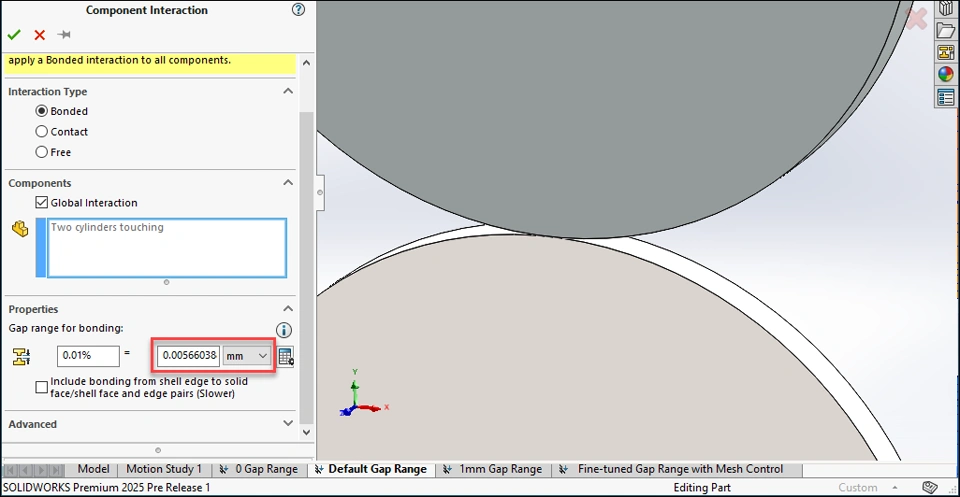

What will happen if instead of a 0mm Gap range for bonding, we use the default value (0.00566038868mm in this case)?

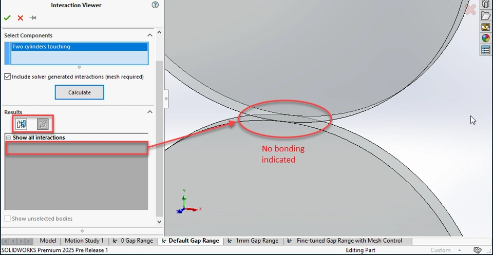

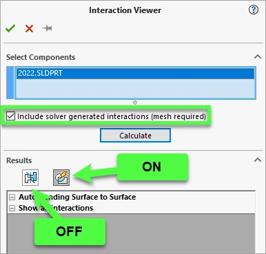

This time, instead of running the study, let’s use the Interaction Viewer.
In case you didn’t read the aforementioned blog topic about the Interaction Viewer, here’s something you must not overlook when using the tool in this context:
- Be sure the study has an up to date Mesh.
- Turn on the Include solver generated interactions (mesh required) option.
- Click Calculate.
- IMPORTANT: Hide Geometry Based Interactions by turning OFF the toggle button on the left.
- Be sure that Solver Based Interactions are shown (turn ON the toggle button on the right if needed).
With only Solver Based Interactions showing, we see that there will not be any bonding. Sure enough, if you run the study, the results are identical to the 0mm gap range study (bodies move apart freely).

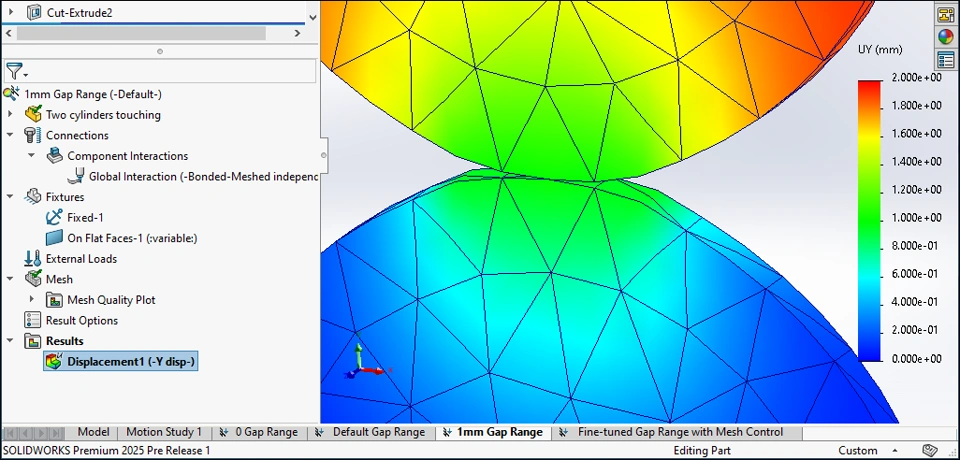

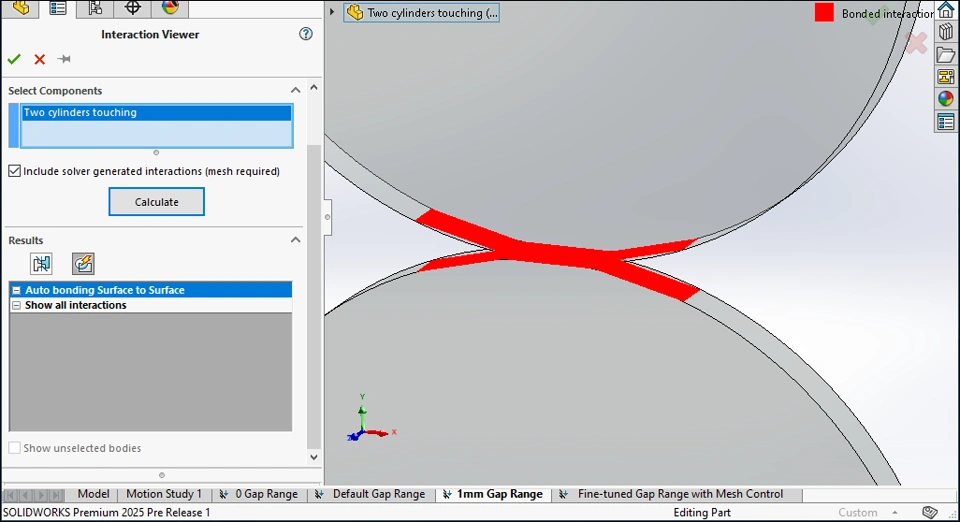

Here’s what the Interaction Viewer shows with a Gap range for bonding of 1mm:
Clearly, the area getting bonded extends much further away from the very small region where the cylinders touch (which is actually an edge in the CAD geometry). For the purposes of this example, let’s imagine that you want to represent the effect of a very small amount of adhesive between the two cylinders. Therefore, the bond should not extend far away from the common tangent edge (if instead you wanted to represent a weld bead, perhaps a bonded area this large would actually be desirable).
A displacement plot reflects this bonding pattern.
TIP: Animate the plot for an even better visualization of the effect of the bond.

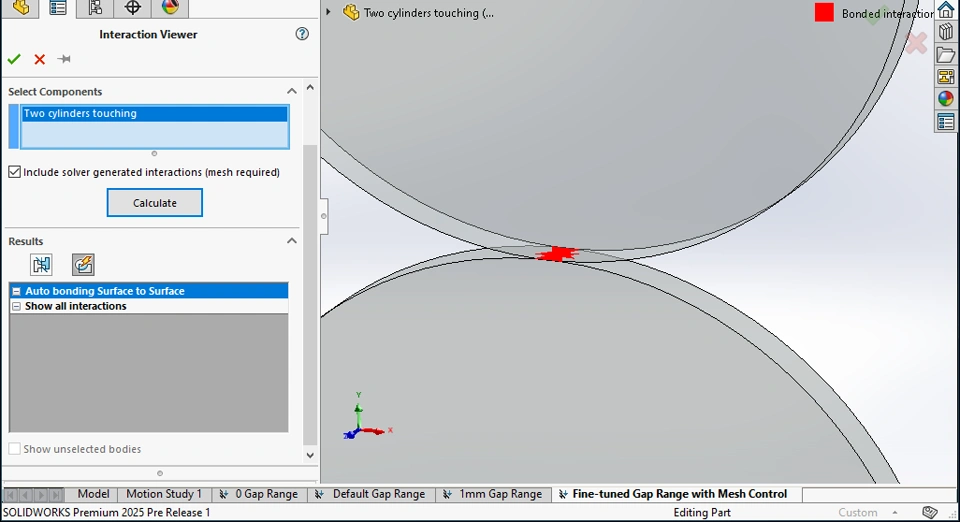

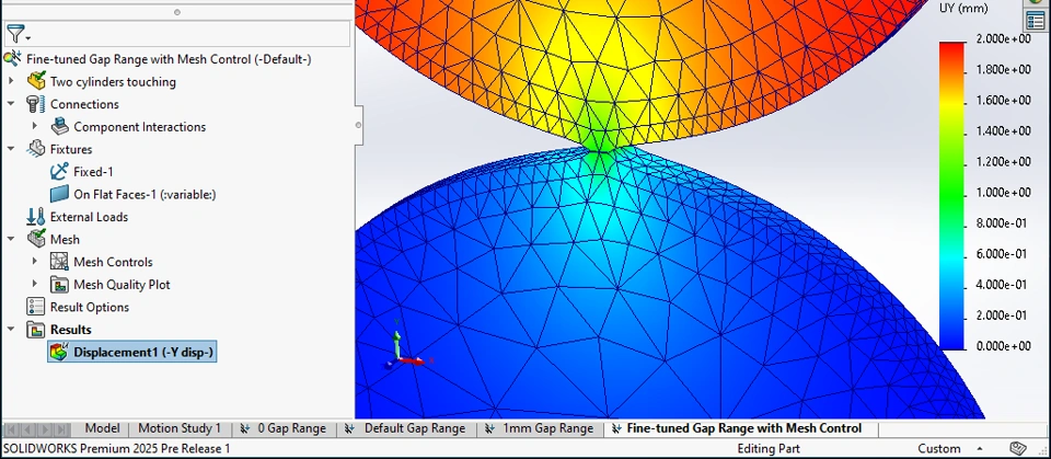

After refining the mesh a bit, here’s what the Interaction Viewer predicts with a Gap range for bonding of 0.005mm
Some further tweaks might be beneficial, but already the results look much closer to what we would expect in real life (if representing a very small amount of adhesive for example):

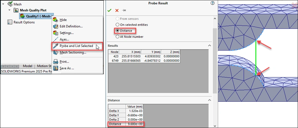

Using Probe > Distance on a Mesh Quality Plot to see distance between nodes can give you a slightly better idea about the effect of mesh tessellation, but remember that the solver generates either Surface to Surface or Node to Surface interactions - not Node to Node interactions. Therefore, even if the distance between a pair of nodes falls within a certain value, this is not necessarily the value that the solver references when it generates bonds or contacts.

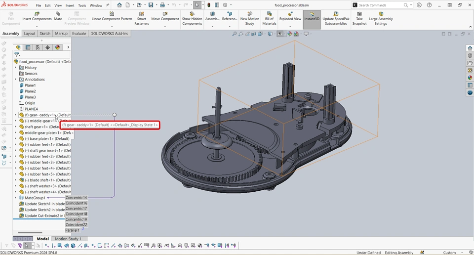

Let’s say you’re working on an assembly, each with specific custom properties like Material, Weight, Part number, etc. Instead of opening each part individually to check these properties, you can leverage tooltip and have a quick glance at the components with the applied filter:

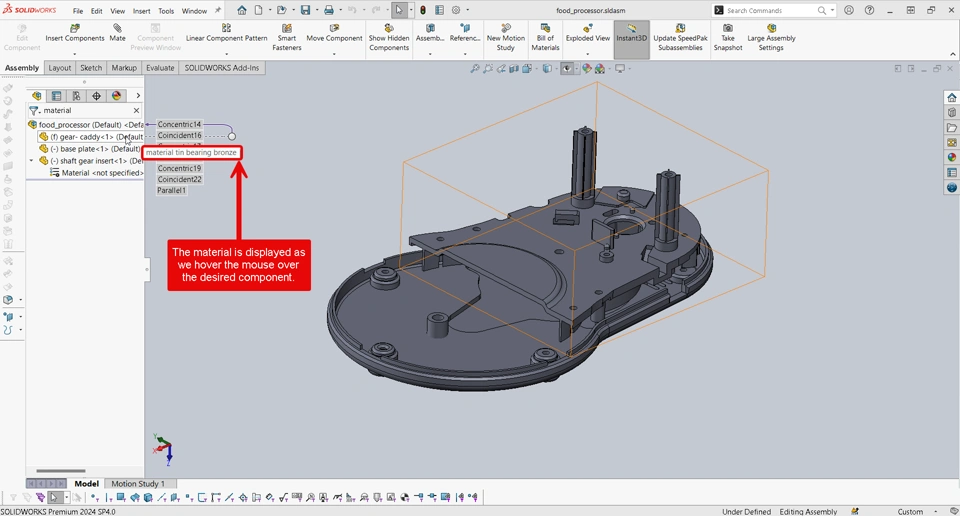

- Search Filter in FeatureManager Design Tree: Use the search filter to locate parts based on specific custom properties. For example, search for ’Material’ to find all parts where this custom property is used.
- Tooltip Usage for Custom Properties:
- Hover over each part in the FeatureManager Design Tree. The tooltip will display essential information, including custom properties like ‘Material’, directly within the assembly context.
- This capability allows you to gather necessary data swiftly without disrupting your workflow, ensuring efficient management of large assemblies.

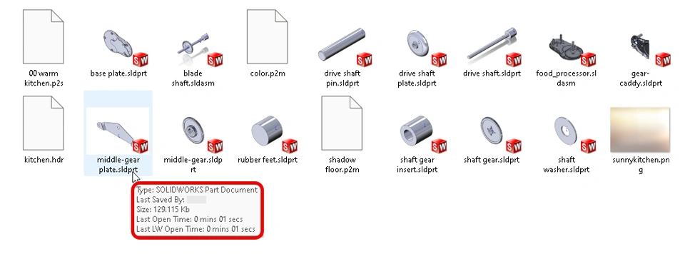

For SOLIDWORKS files specifically, tooltips in File Explorer can be particularly useful. When you hover over a SolidWorks file (such as a .sldprt for a part, .sldasm for an assembly, or .slddrw for a drawing), the tooltip might display:
- File Name: The name of the SolidWorks file.
- File Type: The extension (e.g., .sldprt, .sldasm, .slddrw).
- Size: The size of the file.
- Date Modified: The last time the file was modified.

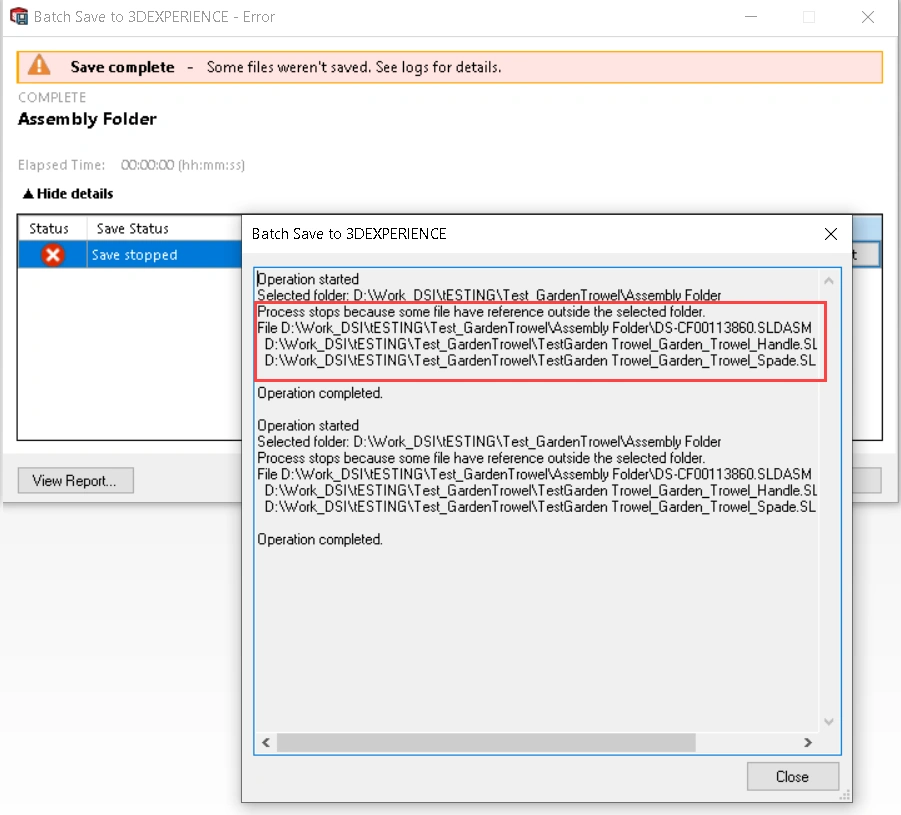

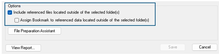

When using Batch Save to 3DEXPERIENCE, you may encounter the error “Process stops because some files have reference outside the selected folder.” This error occurs when the reference files for an assembly are located outside the folder of the main assembly you’re trying to upload.
During the Batch Save operation, a ‘save.xml’ file is generated at C:\\Users\\
Error:
File
Resolution:
To resolve this issue, enable the “Include referenced files located outside the selected folder(s)” option in the Batch Save to 3DEXPERIENCE dialogue box. This will allow you to upload the file along with its referenced files, even if they’re located outside the selected folder.
If you need the referenced part files and their assembly to be present in the same bookmark on the platform, also enable the Assign bookmark to referenced data located outside of the selected folder option in the Batch Save to 3DEXPERIENCE dialogue box. This option is available in Design with SOLIDWORKS and SOLIDWORKS Connected applications from version 24x FD02 onwards.
