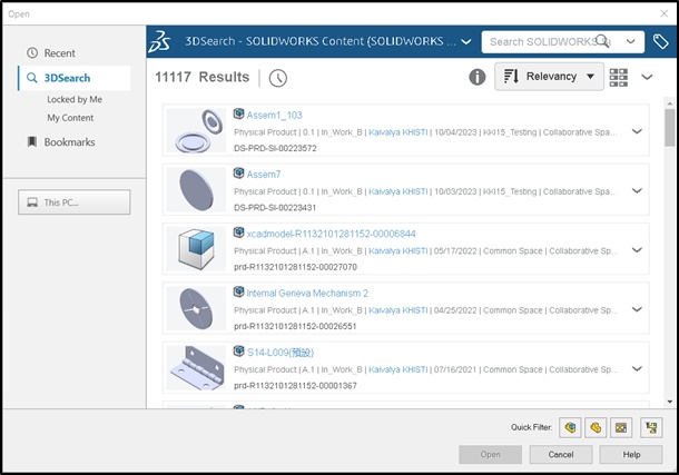

The improved open dialog box in 3DEXPERIENCE® SOLIDWORKS (SOLIDWORKS® Connected) enables you to search and open content located on 3DEXPERIENCE platform as well as your computer more easily.​​​​​​​

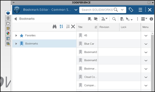

You get access to content stored in Bookmarks and My Content via the first two tabs. For accessing this content, you should be connected to My Session tab.​​​​​​​
Clicking on the This PC button takes you to the regular open dialog box that you are used to, and opens files from the computer’s local drive.

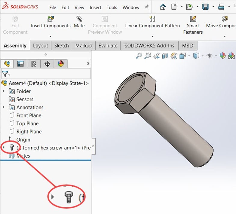

One of the reasons for this behavior is that the component used in assembly is not an original Toolbox component, but a normal part added with a Toolbox flag. To demonstrate this behavior, refer the below procedure:
A. First, add Toolbox flag to the normal part using as shown in below image:

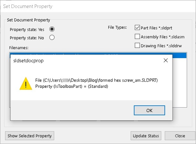

  2. Navigate to below location in Windows Explorer [C:\\Program Files\\SOLIDWORKS Corp [version]\\SOLIDWORKS\\Toolbox\\data utilities]
  3. Run the process ‘sldsetdocprop.exe’
  4. In Set Document Property dialog, define the toolbox state for the part: Select ‘Property state: Yes’
  5. Browse the part using Add Files and click Update Status
  6. To check if a listed part has the Toolbox flag, click on Show Selected Property button and it will display warning shown here.​​​​​​​

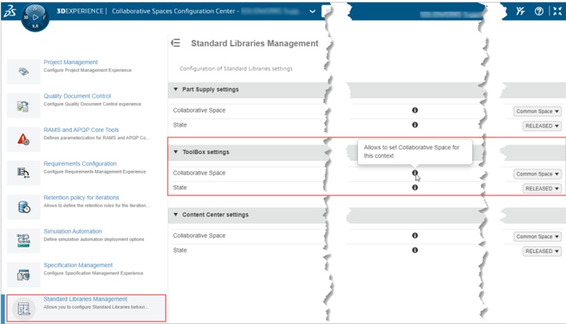

B. Make sure the Toolbox settings section of the Standard Libraries Management widget of Collaborative Spaces Configuration Center is set to ‘Released’.

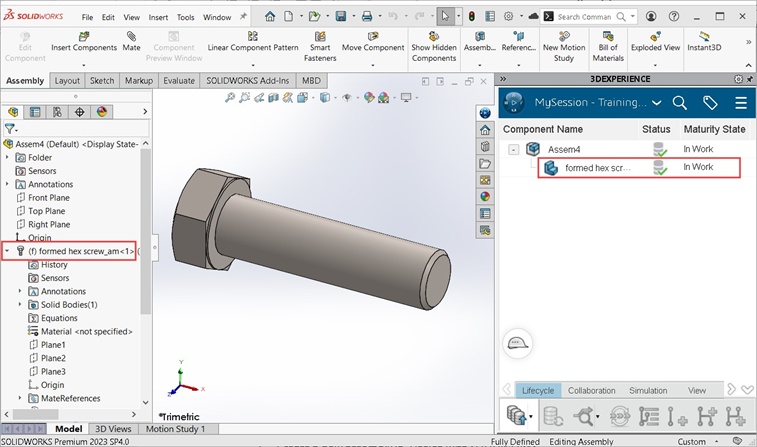

C. Save the normal component with Toolbox flag, to 3DEXPERIENCE platform:
  1. Create a new assembly in Design with SOLIDWORKS
  2. Insert this component into an assembly
  3. In MySession tab, save both files to platform. Observe the maturity state display as In Work instead of Released.

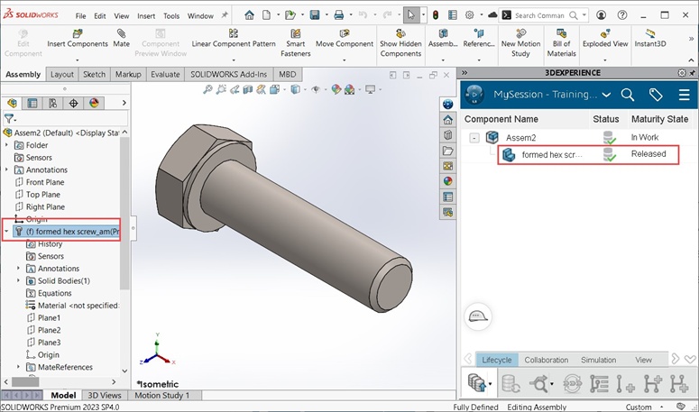

D. Add this component with flag to Toolbox:
  1. Launch Design with SOLIDWORKS®.
  2. Enable Toolbox add-in
  3. Go to Tools, Options, Hole Wizard/Toolbox, Configure
  4. Select Customize your hardware, right-click on any Toolbox Standard and select Add File
  5. Browse the normal component having Toolbox flag
  6. Save the changes in Toolbox and click OK
  7. Then right-click on the Toolbox component in FeatureManager® design tree, select Edit Toolbox Components and click OK without making any changes.
  8. Notice the maturity state display correctly as Released.​​​​​​​
