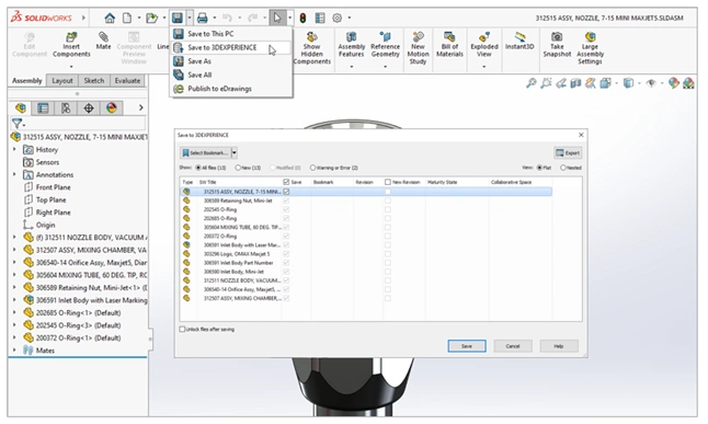

Interactive Save from SOLIDWORKS to 3DEXPERIENCE
The Save to 3DEXPERIENCE command is the regular save option available from both the SOLIDWORKS File menu and the MySession Task Pane. This is an interactive save command that securely uploads SOLIDWORKS files and creates corresponding SOLIDWORKS items in the chosen Collaborative Space.
Note: To increase performance when saving large datasets the interactive save can be configured to run asynchronously. When asynchronous save is enabled in MySession options, the save to 3DEXPERIENCE operation will run in the background enabling the user to continue working in their SOLIDWORKS session.
Interactive save from SOLIDWORKS is suited to uploading single file sets one at a time.

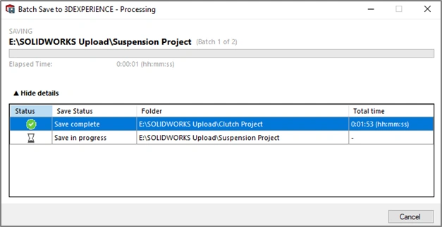

Batch Save to 3DEXPERIENCE
The Batch Save to 3DEXPERIENCE tool is available from the SOLIDWORKS Tools menu. This is an automated, asynchronous tool that has the same secure upload capability as the Save to 3DEXPERIENCE command. It provides the ability to save SOLIDWORKS files from multiple folders into various collaborative spaces and bookmarks in a single operation.
The Batch Save utility is suited to large datasets that contain multiple projects with a datasize <5GB. Once a Batch Save is underway, the tool will run asynchronously in the background enabling the user to continue working in their SOLIDWORKS session.
