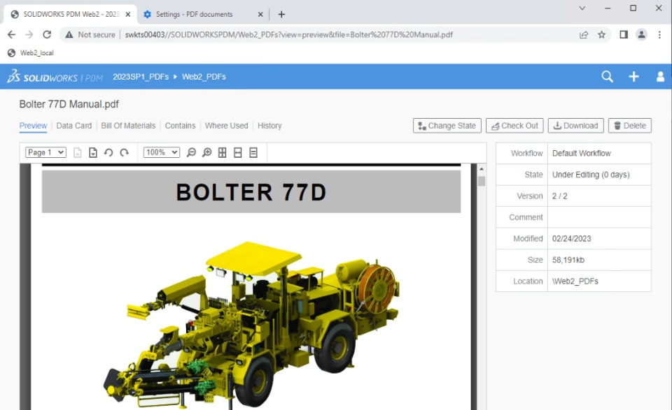

Web2 for SOLIDWORKS PDM Professional 2023 SP1 and later versions now supports the native PDF Viewer functionality for many desktop web browsers (Chrome, Edge, etc).
Most desktop browsers will default to native PDF viewer, but depending on settings you may need to enable the native viewer.

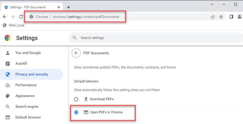

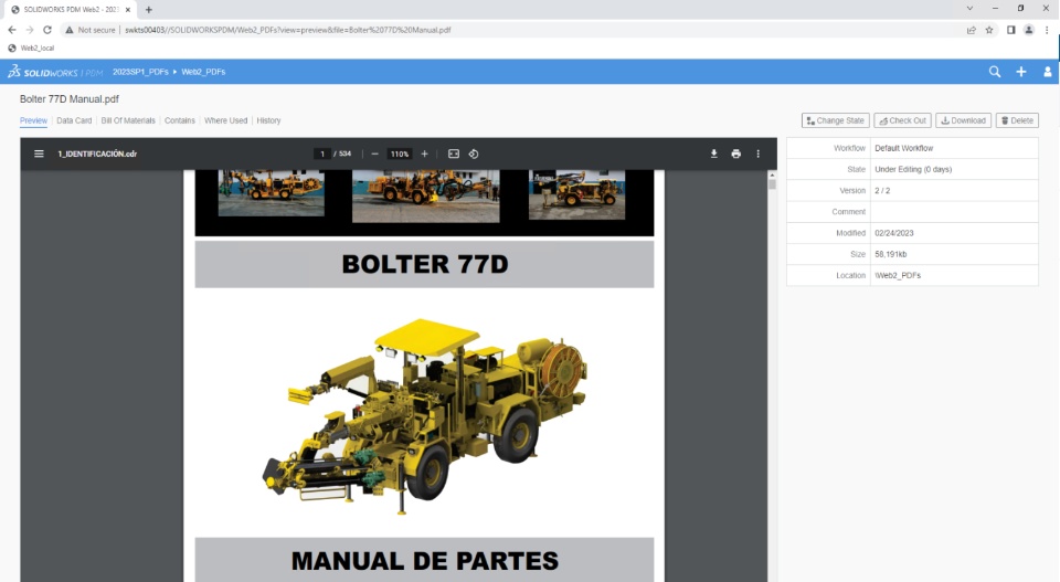

To configure Chrome to use the native PDF viewer:
  1. In Chrome, go to: chrome://settings/content/pdfDocuments
  2. Set Open PDFs in Chrome
  3. In Web2, a PDF preview loads in the Chrome native PDF viewer.

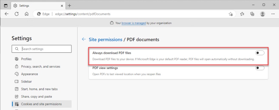

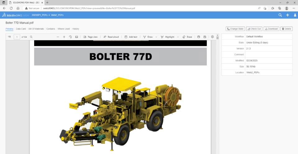

To configure Edge to use the native PDF viewer:
  1. In Edge, go to: edge://settings/content/pdfDocuments
  2. Disable Always download PDF files
  3. In Web2, a PDF preview loads in the Edge native PDF viewer.

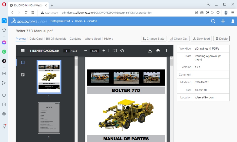

To configure Opera to use the native PDF viewer:
  1. In Edge, go to: opera://settings/content/pdfDocuments
  2. Set Open PDFs in Opera
  3. In Web2, a PDF preview loads in the Opera native PDF viewer

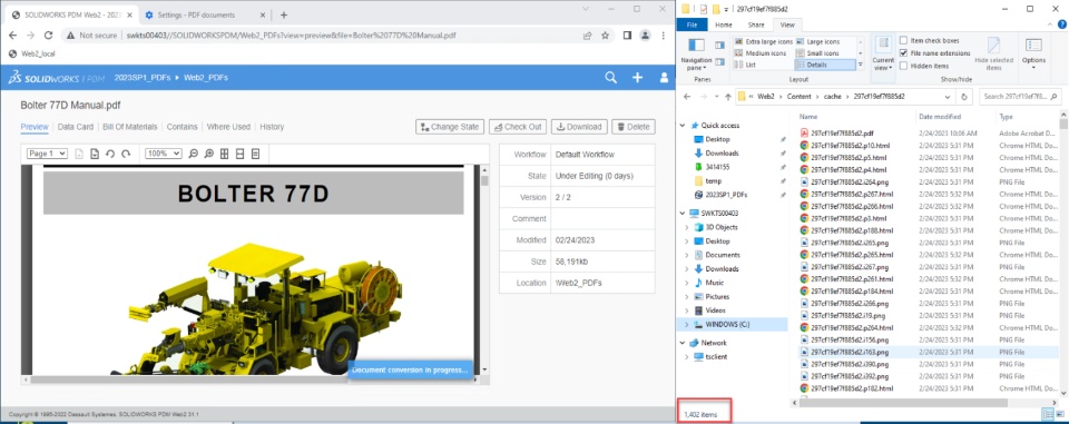

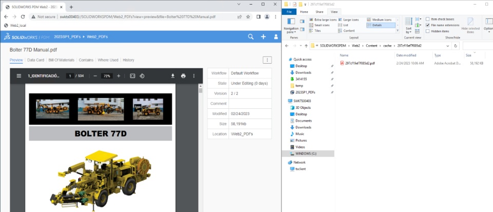

On the Web2 IIS server and client, the following occurs when a desktop web browser previews PDFs in Web2.
  1. On the Web2 IIS Server, a folder is created using a unique session ID.
  2. On the Web2 IIS Server, the PDF is copied from the vault to the session folder.
  3. On the Web2 client, the PDF displays in the web browser.
If the desktop web browser does not support native PDF viewer or configured to download PDFs, Web2 falls back to use the Oracle OutsideIn Web View.
On the Web2 IIS server and client, the following occurs when previewing PDFs with Oracle OutsideIn Web View.
  3. On the Web2 IIS Server, the Oracle OutsideIn preview application will extract images and text from the document and generate html pages with the preview content in the temporary session folder.
  4. On the Web2 client, the PDF displays in the Preview.

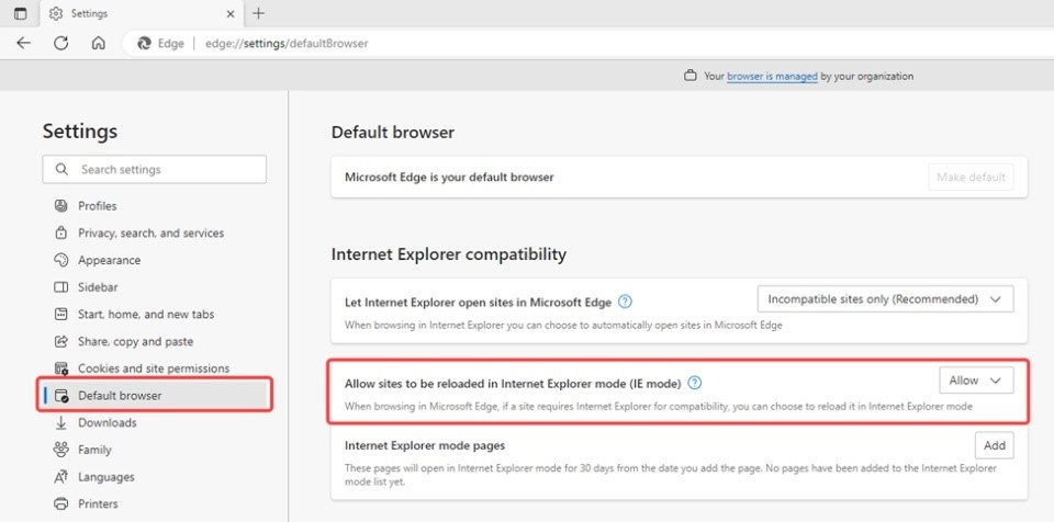

With rollout of Windows 11 Operating System, the well-known Internet Browser “Internet Explorer “  retired with a permanent disable via Microsoft Edge Update on 14th February 2023. Thus with Microsoft Windows 11 Operating System, there is no “Internet Explorer” browser. This results in a difficulty for most of the SOLIDWORKS Composers users who relied on Internet Explorer browser to access the HTML Output generated from SOLIDWORKS Composer Application.
Here is a method to access the HTML Output from SOLIDWORKS Composer in a Windows 11 Operating System Installed machine with the inbuilt “Microsoft Edge” Browser. Follow the steps mentioned below :

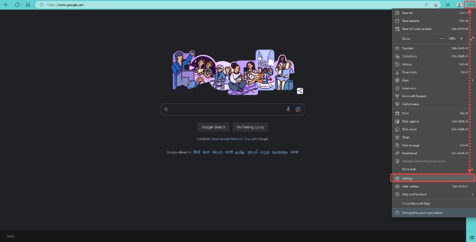

  1. Initiate Microsoft Edge. Hit the 3 dots (in right top corner) > Settings.
  2. In the “Default Browser” settings, Set the option “Allow sites to be reloaded in Internet Explorer (IE mode)”

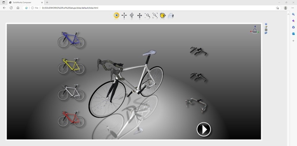

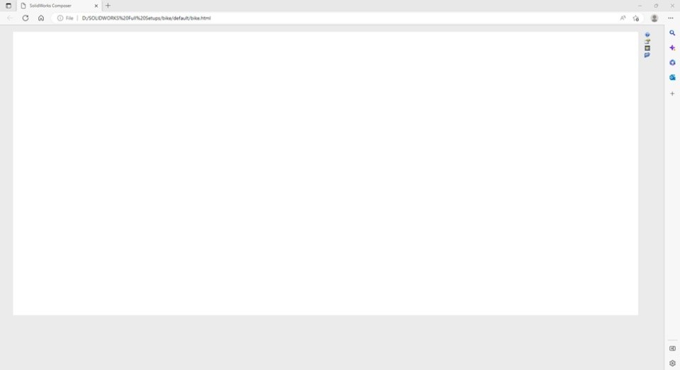

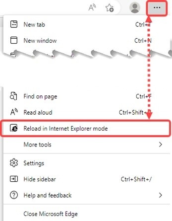

  3. Open an HTML file generated from SOLIDWORKS Composer in Microsoft Edge. Notice that the HTML is displayed blank.
  4. Hit the 3 dots (in right top corner) > ”Reload in Internet Explorer mode.”The browser may request install of ComposerPlayerActiveX.cab if the machine does not have SOLIDWORKS Composer or SOLIDWORKS Composer Player installed already. Install the required ComposerPlayerActiveX.cab and “Allow blocked content” in the browser.
  5. The HTML file is accessible now within Microsoft Edge Browser.

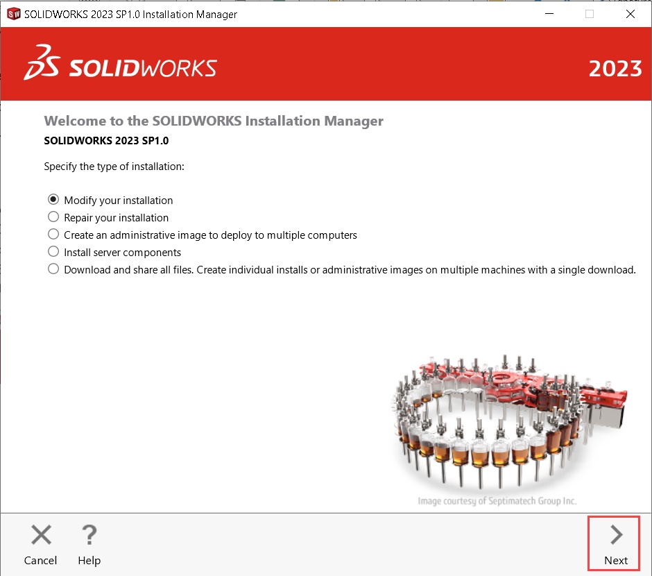

  1. Open Control Panel > Programs > Programs and Features.
  2. Right-click SOLIDWORKS and select Change.

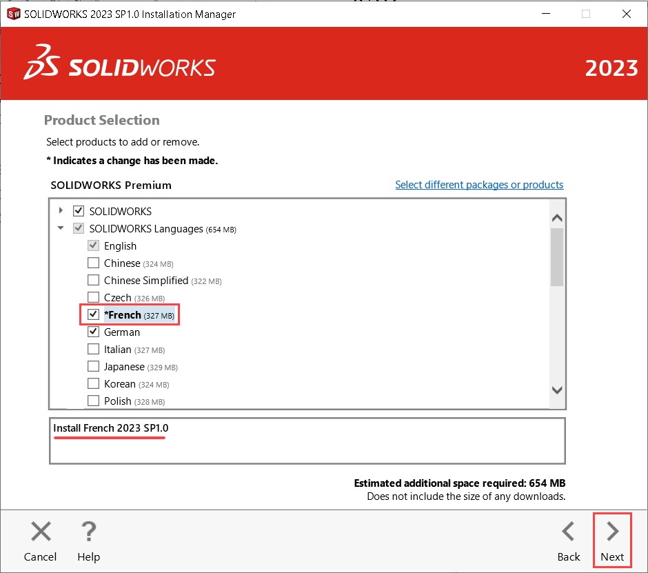

  3. In the SOLIDWORKS Installation Manager, click ‘Next’ until the Product Selection screen appears.
  4. Select the additional language(s) and click ‘Next’.
  5. Further accept the terms from lower left corner checkbox and click ‘Modify now’. This will download the required language pack, once download is completed, close the IM by clicking on ‘Finish’. You can check the files in above mentioned location.

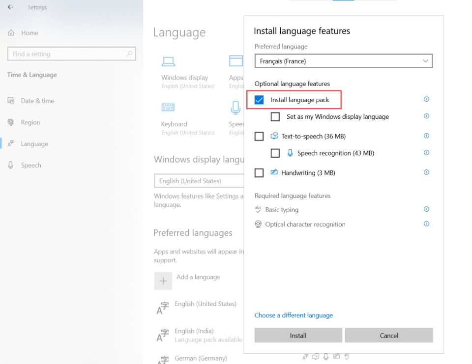

Ensure that the windows consists of same language pack or not from Start Button > Settings > Time & Language > Language > under Preferred language, check whether the language pack is downloaded or not. If not then refer below steps to download the same.

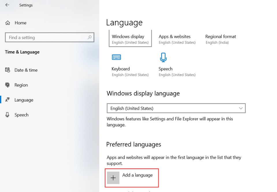

  1. Select the Start button, and then select Settings > Time & Language > Language.
  2. Under Preferred languages, select ‘Add a language’.
  3. Under Choose a language to install, select or type the name of the language that you want to download and install, and then select ‘Next’.
  4. Under Install language features, select the feature ‘Install Language pack’ and then select Install. However for our purpose only language pack is needed, so you can select only ‘Install Language pack’.
  5. Close the settings.

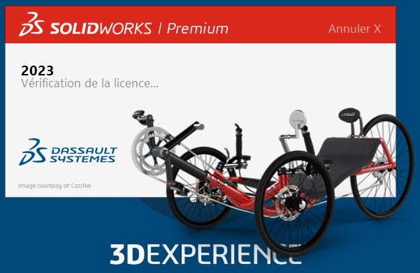

And yes, that’s it, now we are all set to launch SOLIDWORKS in foreign language, once the desired language packs are available in both conditions :
  1. Now refer below steps to proceed further
  2. Now under Time & Language > Language > under ‘Windows display language’ > select the desired language from dropdown list, the newly downloaded language appears in dropdown list > select ‘No, sign out later’ > close the window.
  3. Launch SOLIDWORKS > it now opens in foreign language.​​​​​​​​​​​​​​
