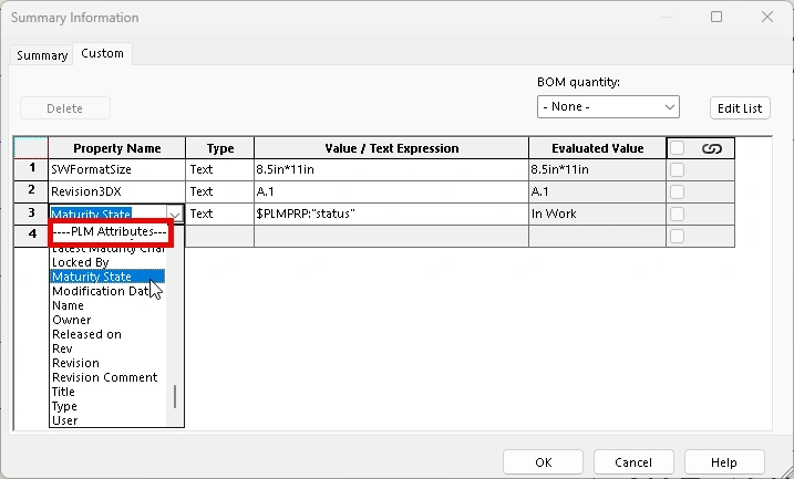

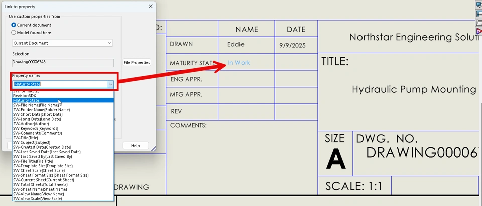

To link a field:
  1. Open the drawing in Edit Sheet Format mode.
  2. Insert a note in the required title-block field.
  3. Select Link to Property, then click File Properties.
  4. Under Custom, select the required property from the PLM Attributes list.
  1. Return to Link to Property, select the added property, and confirm the link.
  1. Repeat for the remaining fields and save the updated sheet format.
[Link: Linking PLM Properties in a Title Block]

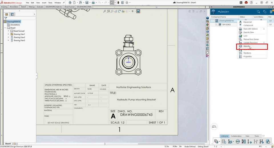

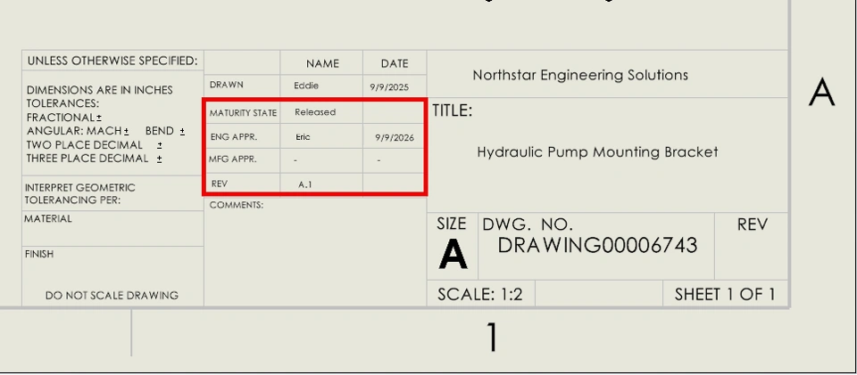

Once the title-block fields are linked to the required PLM attributes, they reflect the current lifecycle information from the 3DEXPERIENCE platform. In this example, the drawing is initially In Work at revision A.1.

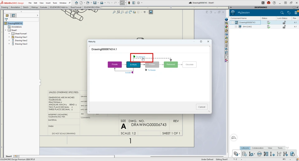

In the MySession task pane panel, right-click the drawing and select Maturity.
Lifecycle Promotion
The Maturity dialogue displays the drawing’s current state and available transitions. An authorized user selects To Release to promote the drawing from In Work to Released.
After promotion, the linked title-block fields update to show the Released maturity state and the associated approval information. The revision remains A.1 because changing the maturity state does not create a new revision.
No manual title-block editing is required after the lifecycle transition.

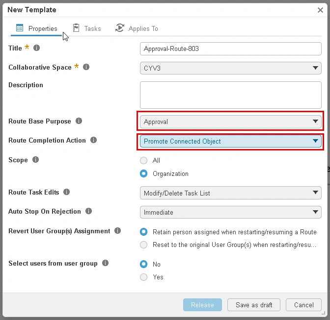

Configure the Approval Route
In the Route Management app, create a route template and configure:
  • Route Base Purpose: Approval
  • Route Completion Action: Promote Connected Object

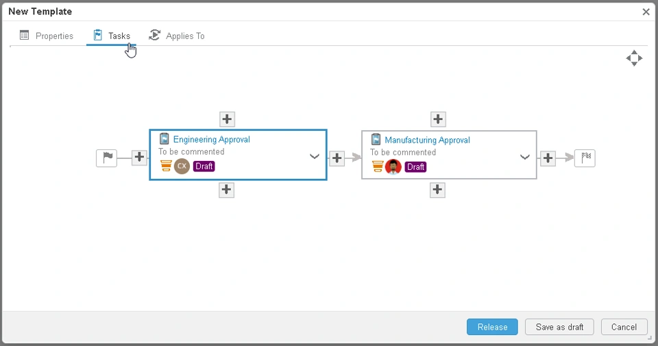

Under Tasks, add Engineering Approval as the first task and Manufacturing Approval as the second. Assign the appropriate reviewer to each task, apply the changes, and release the route template.
Best Practice: Create and release standard route templates for approval processes that will be reused across drawings.

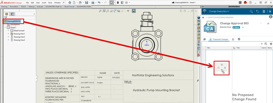

Initiate the Drawing Approval
Set the drawing’s maturity state to Frozen before starting the approval process. This prevents changes while reviewers evaluate the drawing.

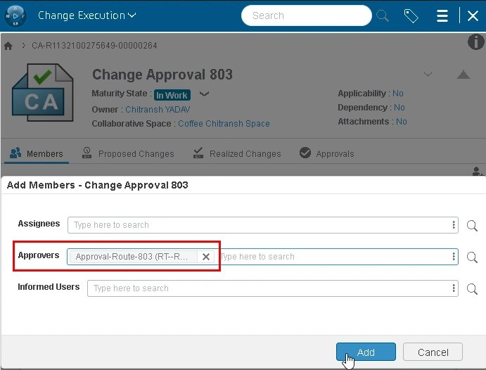

In the Change Execution app, create a New Change Action and add the released route template under Members > Approvers.
Under Proposed Changes, drag and drop the frozen drawing from SOLIDWORKS Design while holding the Alt key. Then move the Change Action to In Approval. If the Change Action was created in Draft, first move it to In Work.

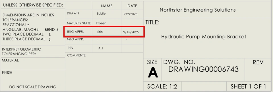

The engineering approver opens the assigned Change Action, reviews the drawing in 3DPlay, and completes the Engineering Approval task. Once completed, the Manufacturing Approval task becomes available to the next approver.

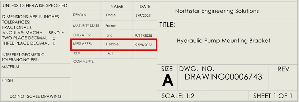

After the manufacturing approver completes the second task, the route finishes and promotes the drawing from Frozen to Released. The linked title-block fields are populated with the approver names and approval dates.
Automatic Approval Stamping
As each approval task is completed, the related PLM attributes are updated. Because the drawing title block references these attributes, the stamping information is updated automatically.
For example:
  • When the engineering approver approves the task, the engineering approver name and approval date are reflected
  • When the manufacturing approver approves the task, the manufacturing approver name and approval date are reflected.
  • When the drawing is released, the title block reflects the released maturity state.
This eliminates the need for designers to manually update approval names, dates, and lifecycle status in the drawing.

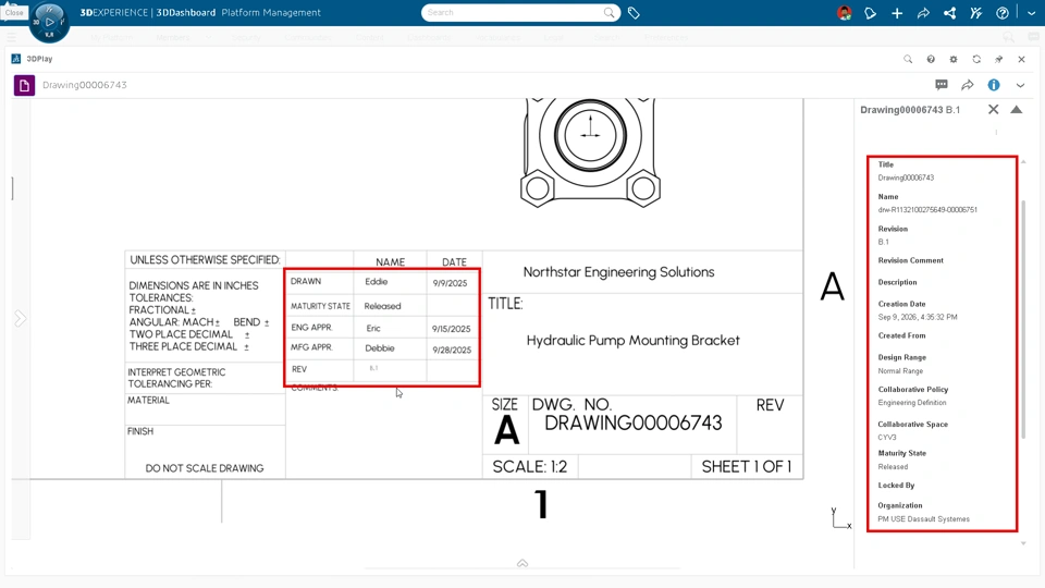

7. Viewing Stamped Drawings in 3DPlay
Stamped drawings can be viewed directly in 3DPlay without opening SOLIDWORKS Design. The title block displays the linked lifecycle and approval information, while the Attributes panel shows the corresponding revision and maturity state from the 3DEXPERIENCE platform.
