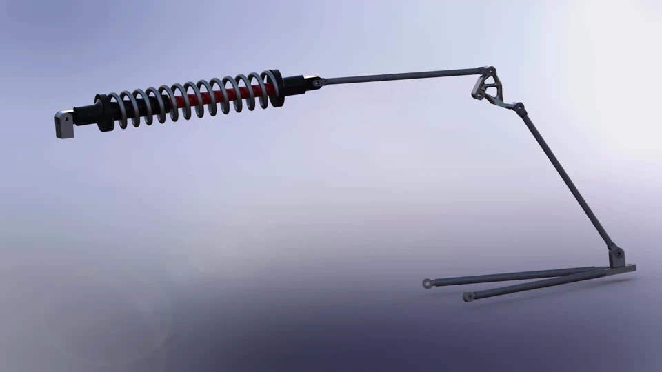

Creating an animation for a suspension system involves intricate dependencies and precise assembly. In this example, we'll delve into the process of animating a Double Wishbone Suspension System, commonly found in high-performance vehicles like Formula Cars, utilizing external references for dynamic motion.

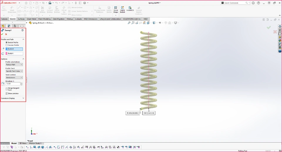

1. Model Components Individually: Begin by modeling each component separately: the Spring, Damper, Bell Crank, Push Rod, and A-arm (Upper A-Arm). Notably, the Spring is created using the Sweep command. Here's a step-by-step guide:

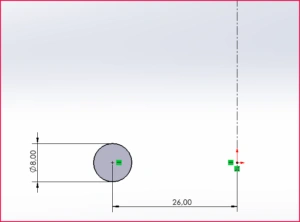

  • Defining Spring Profile:
    1. Start by drawing a circle to define the coil profile.
    2. Constrain the profile's location to specify parameters such as wire diameter and coil outside diameter.
  • Path Definition:
    1. Define the path for the sweep, typically aligned with the spring's free length.
    2. Ensure one end of the path remains unconstrained in the sketch, allowing for path length adjustments.
  • Sweep Creation:
    1. Navigate to Features > Swept Boss/Base.
    2. Select the sketch for both Profile and Path under Profile and Path options.
    3. Configure sweep options accordingly.
    4. Confirm by clicking Ok.

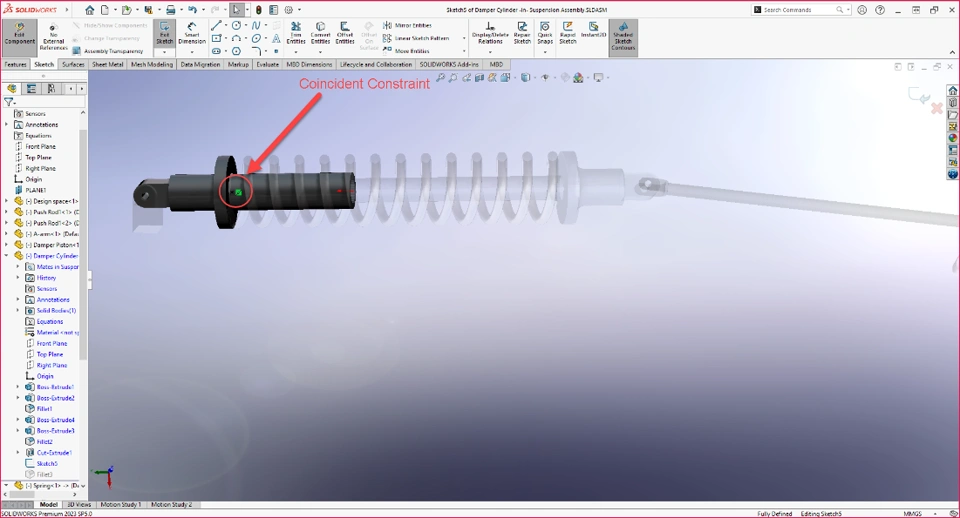

2. Assembling Components with External References: Assemble the components, ensuring proper mates to facilitate desired motion. Notably, the spring is placed around the damper, necessitating external references. Here's how:
  • Creating References:
    1. Identify points of reference, such as the concentricity between the damper cylinder and the spring.
    2. Enter the part's Edit Part mode.
    3. Access the spring's Path sketch and establish a coincident constraint between the unconstrained endpoint and the designated point on the Damper Piston.

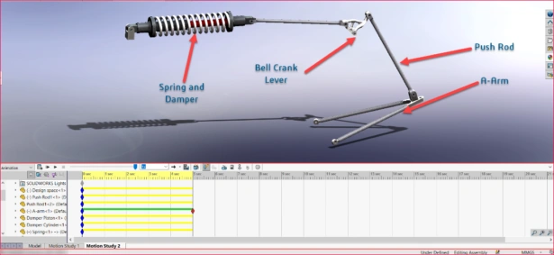

3. Animating the Assembly: Animate the assembly to visualize its dynamic behavior using the following steps:
  • Setting Up Motion Study:
    1. Access the Motion Study tab.
    2. Adjust the time bar to determine the animation duration.
  • Animating the Components:
    1. Drag the components to their desired end positions.
    2. Calculate and play the animation to observe the system's motion.
Leveraging External References for Dynamic Animation: External references play a crucial role in accurately depicting the compression of the spring and the overall motion of the suspension system in this example. By calculating each frame with respect to these references, the animation realistically portrays the system's behavior.
Conclusion: Animating a suspension system with external references adds depth and realism to the animation. By meticulously modeling and assembling components, and leveraging external references, you can create dynamic animations that effectively illustrate the system's functionality.
Below showcases the end result of the animation:

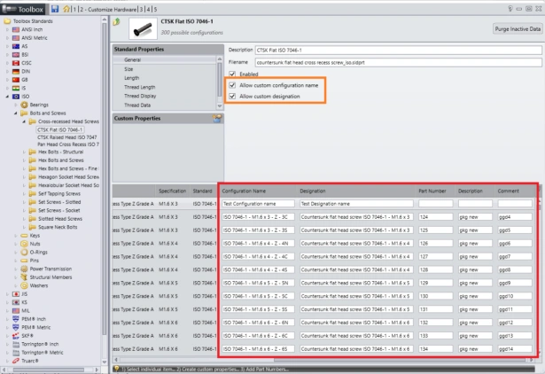

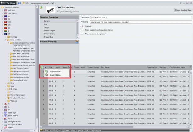

1. Why I am not able to add any additional configuration to the table using the export and import option?
When you're handling exported data in Microsoft Excel®, you only have the option to input Part Numbers, Descriptions, and Comments which are the user input fields.
You can even customize configuration names and designations within the designated columns but only when 'Allow Custom Configuration name' and 'Allow custom designation' is checked. Meaning these columns are also opened for user input data.
But it's important to note that user must refrain from adding or modifying any other information within the spreadsheet.
Even though you can see properties like Size, Length, Recess Type etc. definitions for Toolbox components in the table, you should not specify or change the value definitions in the spreadsheet.
Any alterations made to data in columns outside of these specifications will result in the spreadsheet failing to import correctly into the Toolbox Settings.
Most common mis-understanding related to this option is we can add new size and all the configurations in the excel table and import it directly in the Toolbox which is not true. The import and export of excel is for the text editable fields like Configuration Name, Designation, Part Numbers, Descriptions, and Comments.
You can only add new size from the Toolbox > Standard Properties > Size.
