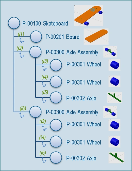

Instance, Reference, [Occurrence], Port and Connection (IRPC) Model
The IRPC model, is a core concept in the 3DEXPERIENCE platform. IRPC stands for Instance, Reference, [Occurrence], Port, and Connection. This model is the foundation for how the platform structures and manages data. Both the product model and the PPR (Product, Process, Resource) data model are built on IRPC. Like many other models in 3DEXPERIENCE, the product model and the PPR data model are based on the IRPC model.
The IRPC Model can be illustrated in a simple skateboard example:

The simple skateboard example described with the IRPC model:1 board, 2 axle assemblies and each axle has 2 wheels, totaling 4 wheels on the skateboard.
A Reference is the original design of a part (blueprint) — its main definition in the system. It’s identified by TNR (Type, Name, Revision).
  • Example: P-00301 Wheel is one Reference. It describes what a wheel looks like (size, color, shape, material, etc.), no matter where we use it, it’s the same Reference.
An Instance is a specific use of that Reference inside a parent assembly.
  • Example: P-00300 has 2 wheel instances (i3 and i4). Both use the same wheel Reference (P-00301), but each has its own position and connection inside the axle. Think of it like: one design (wheel) used twice on the same axle.
An occurrence is the full path by which that object appears in the product structure, from the top level down.
  • Example: The skateboard has 2 axles, each with 2 wheels, so 4 wheel occurrences in total.
    • Skateboard → Axle 1 → Wheel A
    • Skateboard → Axle 1 → Wheel B
    • Skateboard → Axle 2 → Wheel A
    • Skateboard → Axle 2 → Wheel B
Summary:
  • A Reference is the actual part, such as a wheel or a board.
  • An Instance is how that part is used in a specific spot.
  • An Occurrence is the full path from the top product down to that part.

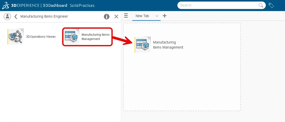

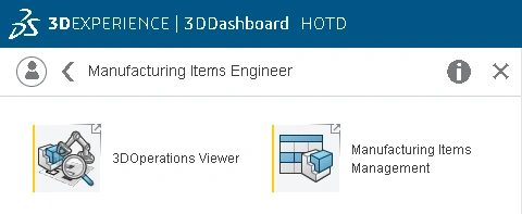

Setup

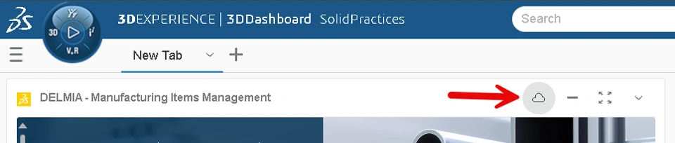

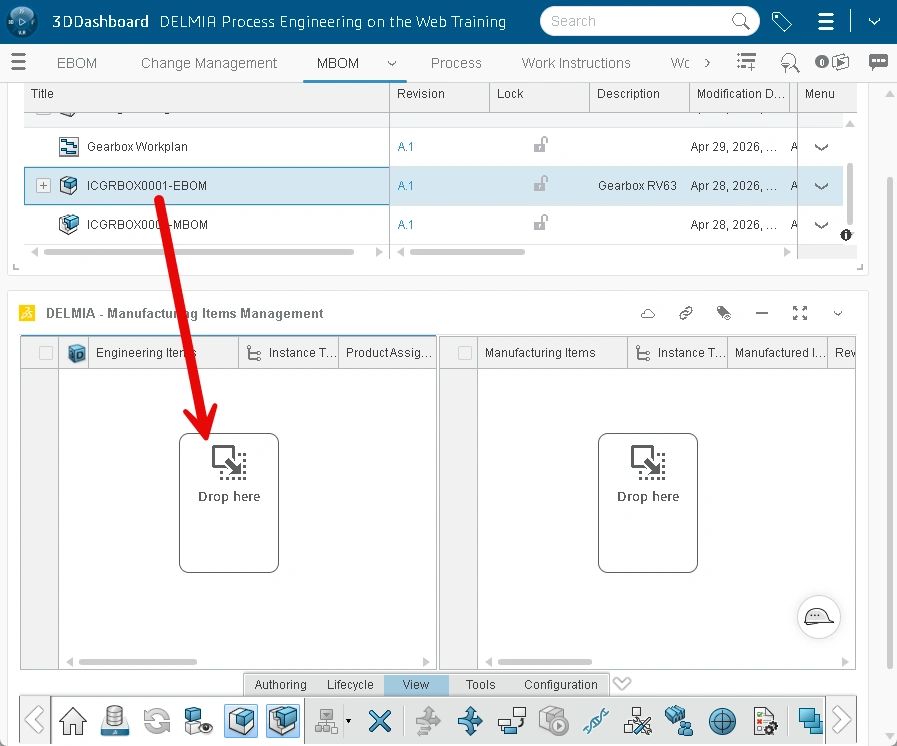

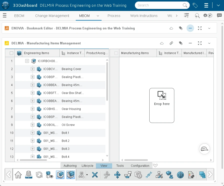

Once the Manufacturing Items Engineer role is assigned, users can add the two apps from that role to a dashboard. Create a new dashboard, expand the "My Roles" or "My Apps" menu under the Compass and drag the Manufacturing Items Management app into a dashboard tab. Additionally, drag the 3DOperations Viewer app onto the dashboard.
Once both applications have been added to a dashboard, they can be linked together. Use the "carrot" style context menu in either application, select "Link with Web App," then select the other app to finish the linking.

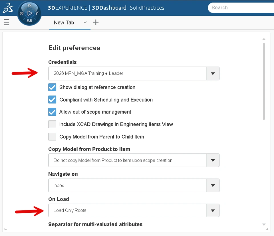

There are a few different ways to control the behavior and settings of the web applications:
  • Through the application itself - discussed below
  • MePreferences Control Center - controls preferences that are often shared amongst multiple applications
  • Collaborative Spaces Control Center - the administration control center enables extensive customization, including custom attribute creation, general DELMIA settings for both web and native Windows and application-specific settings.
Application-specific settings are mostly tied to visualization, loading and the Collaborative Space for working. Once the applications have been added to a dashboard, click the "cloud" icon to set preferences.
The most important setting is "Credentials," which determines which 3DSpace (also called Collaborative Space) is used. Another important setting is "On Load," which determines what happens when the content loads.
To easily add content to the Manufacturing Items Management application, use the Bookmark Editor widget.

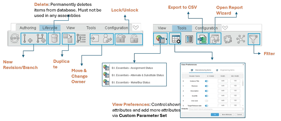

User Interface

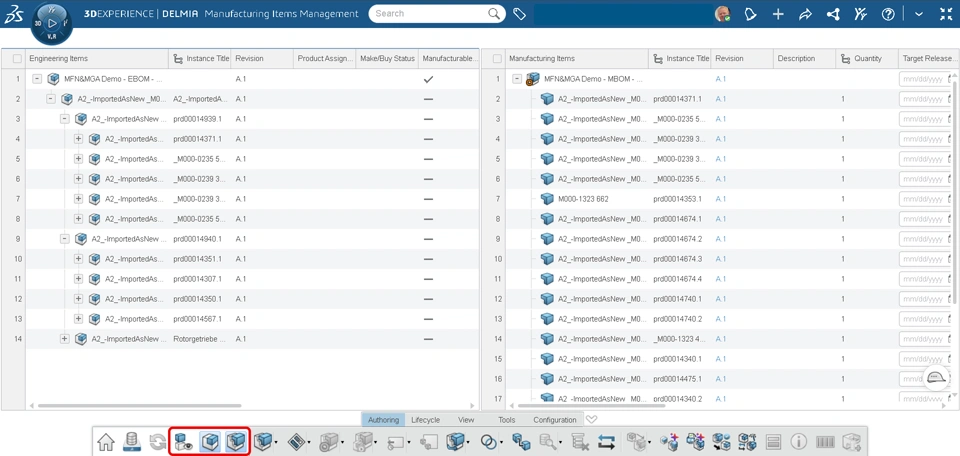

The user interface of the Manufacturing Items Management application consists of two main views and one auxiliary view. Each can be "turned" on or off from the bottom toolbar.
IconDescription
The home icon returns to the Manufacturing Items Management application's homepage.
Auxiliary View: allows storing some objects for later use. Think of this as a "parking lot"
Turn the Engineering Items (EBOM) view on or off.
Turn the Manufacturing Items (MBOM) view on or off.
Notice. Some buttons are greyed out depending on which item (node) is selected in either the Engineering Item or the Manufacturing Item trees.

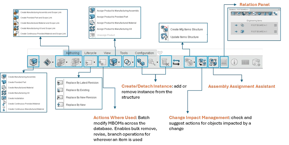

Authoring toolbar
View toolbar
Tools and Lifecycle toolbar

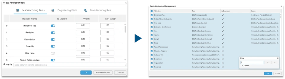

Show Column(s) View Preferences Panel enables customization of the attributes displayed in our main and additional views. Even though the emphasis is on OOTB solutions, one of the 3DEXPERIENCE platform's key strengths is customization. One of many ways users can customize and control the view of the web applications. In many cases, users might have custom attributes they will need to visualize.
  • Note: this panel also controls the order of the headers.
  • If more attributes are selected, the user can add more attributes and generate a Custom Parameter Set to save the view.
  • This is applicable to many of the DELMIA Web applications for Process Engineering.

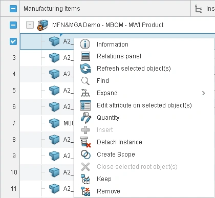

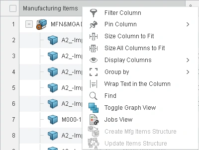

All web applications have a contextual menu that provides shortcuts to commands that are unavailable on the command bar. There are two context menus depending on where the click happens.
Some of the more commonly used commands in the context menu that appears when clicking on the header of a column:
Filter Column allows the user to enter a filter either for a value or a condition.
Display Columns allows the user to add or remove columns from display.
Find allows the user to search and find specific items that match the search criteria.

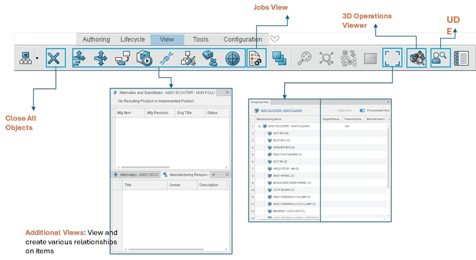

Toggle Graph View allows the user to switch to a graphic view instead of the tree view.
Jobs View allows the user to see the list of the current jobs running on the backend server.
Information allows the user to view detailed information about the selected item,
Relations Panel allows the user to view the current relations for the selected item, including scope, parents and more.
Expand allows the user to expand the tree one or more levels from the selected item.
Quantity allows the user to set a specific quantity for the selected item.
Detach Instance allows the user to detach from the item in the tree.
Create Scope allows the user to set the scope the to the appropriate Engineering Item.
Close selected root object(s) allows the user to remove the selected root item from the session.

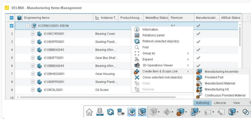

Manual MBOM Creation

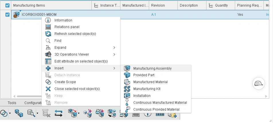

For both use cases, the first step is to identify the Engineering Item(s) (EBOM) that will be the basis for the Manufacturing Item(s) (MBOM) and add the EBOM as the context, which is done by drag & drop onto the left panel in the Manufacturing Items Management application. This can be done from a search result or from the Bookmark Browser, as in the example below.

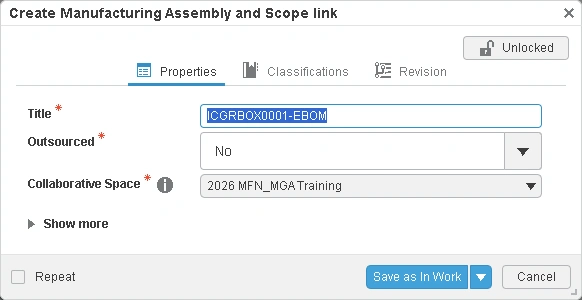

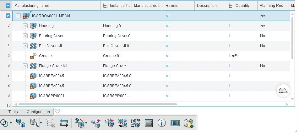

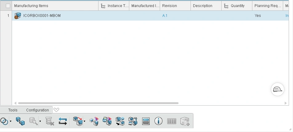

The second step is to create the root Manufacturing Item (MBOM), also called the top-level node. The Create Manufacturing Assembly and Scope Link function can be run from either the Engineering Item context menu or the toolbar. Before the Manufacturing Item is created, the attributes such as Title, Outsourced and Collaboration Space will need to be updated, as in the example below.
The third step is to "build out" the full Manufacturing Items (MBOM) structure by adding more Manufacturing Assemblies, Provided Parts, Manufacturing Materials, etc., as shown in the example below.
BeforeAfter
The fourth step "consume" the leaf nodes from the Engineering Item parts by linking them to the appropriate Manufacturing Item in the MBOM. This can be done by simply dragging & dropping the Engineering Item (EBOM) structure onto the Engineering Items (MBOM) structure, or by using the Assign Product to Manufacturing Assembly function from the toolbar. Select the appropriate function depending on which Manufacturing Item type is the recipient, as shown in the example below.

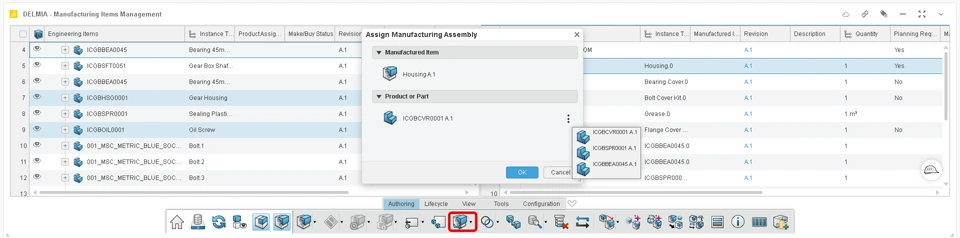

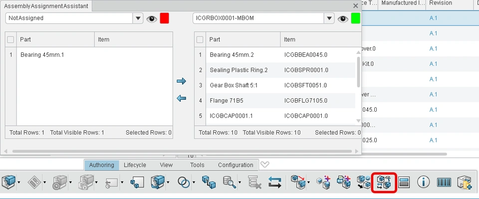

Recently, a new method for "consuming" Engineering Item parts, the Assembly Assignment Assistant, was added, making it easy for users to quickly assign and restructure their MBOM by swapping between subassemblies. In addition, the Assembly Assignment Assistant works in conjunction with the 3DOperations Viewer, as shown in the example below.
Assembly Assignment Assistant (help) is located in the Authoring toolbar

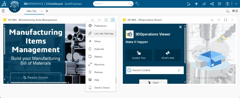

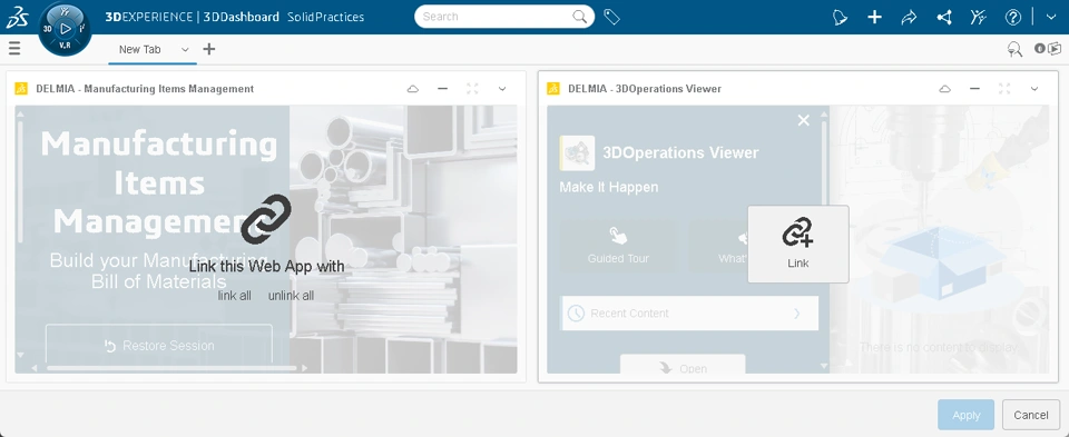

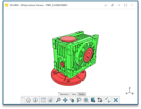

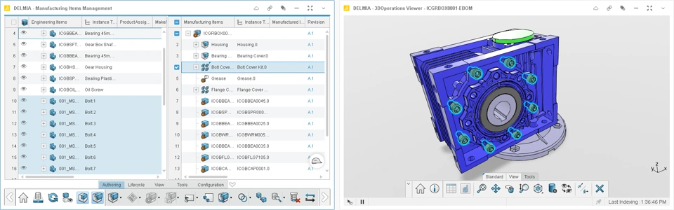

The Manufacturing Items Management application can use 3DOperationsViewer, another application in the Manufacturing Items Engineer role. The 3DOperations Viewer lets manufacturing engineers review the MBOM build-up in 3D and report any issues.
To enable the 3DOperations Viewer, use the Link with WebApp function in the "carrot" drop-down menu of the Manufacturing Items Management application, as shown in the example below.
3DOperationsViewer (help)

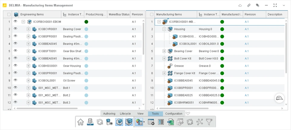

Another useful tool is B.I. Essentials short for Business Intelligence. B.I. Essentials can be used to reveal attributes of the objects in session. Color codes corresponding to the different values of an attribute are applied to the objects. This is very helpful to understand the current progress of the Manufacturing Items (MBOM) development. B.I. Essentials specific to Manufacturing Items Management highlight the assignment status of products and updates and the completion status of Manufacturing Items, as shown in the example below. The B.I. Essentials specific to Manufacturing Items Management can be found in the Tools section of the toolbar.
B.I. Essentials - Assignment Status (help)
B.I. Essentials -Assignment Status
Description
Associated with a scope
The product has a scope link to a manufactured item.
Not assigned
The product is not yet assigned, but can be assigned once the assignment rules and scopes are considered.
Assigned indirectly
The product itself is not assigned, but its parent is assigned to a manufactured item.
Assigned directly
The product is directly consumed by a manufactured item.
Assigned more than once
The product is assigned to at least two manufactured items. This is possible, for example, if the product is assigned to manufactured items that have different effectivities.
Non-assignable
The product cannot be assigned. Considering the scope, some products cannot be assigned because this would violate assignment or scope rules.
B.I. Essentials -
Make/Buy Status
Description
Make
Product scoped to only one non-leaf item type.
Buy
Product scoped to only one leaf item type.
Multiple
Product scoped to more than one leaf/non-leaf item type.
None
Product not scoped to any item.
B.I. Essentials -
Alternate & Substitute Status
Description
No Alternates \\ Substitutes defined
There are no Alternates \\ Substitutes defined on the given Manufactured Item or Product
Alternates \\ Substitutes defined from MBOM
There are MBOM Alternates \\ Substitutes defined on the respective Manufactured Item
Alternates \\ Substitutes defined from EBOM
There is a Alternates \\ Substitutes from the Engineering definition on the given Product and Manufactured Item

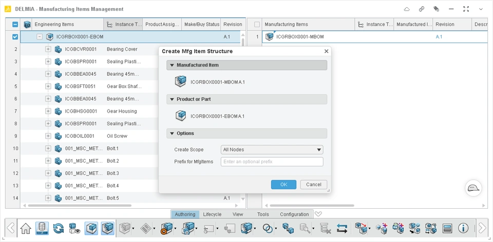

Automatic MBOM Creation
It is possible to automatically create the Manufacturing Items structure (MBOM) from an existing product structure (EBOM) using the Create Mfg Items Structure function on the Authoring toolbar. It's important to understand that the created MBOM can be modified, allowing users to get a head start on the MBOM's development and then break it down further or reorganize it as needed. Before running the automatic MBOM creation tool, the user must add a manufacturing assembly as the root in the Manufactured Items tree. The function will run asynchronously on the 3DEXPERIENCE cloud platform, and the user will be notified when it's complete.
Create Mfg Items Structure (help)
