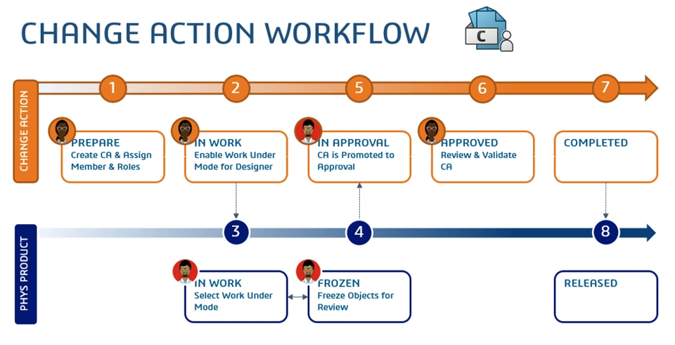

The image below shows an example of a basic change action workflow using the pre-configured “out of the box” behaviour. This represents the recommended use case for SOLIDWORKS customers.
- A manager creates the change action item and assigns the members and defines their roles, and then adds the Physical Products required for the change plus any other supporting documents
- The change action is promoted by the manager from Draft to the In Work maturity state, and new revisions of the attached Physical Products are created
- The designer works on the new revisions of the Physical Products in SOLIDWORKS that were created by the change action
- Once the necessary changes to the design have been made using SOLIDWORKS, the designer promotes the components to the Frozen maturity state.
- The change action is promoted to the In Approval maturity state by the designer
- The manager receives a notification that the change action is awaiting approval. The changes are reviewed and accepted by the manager. The change action is promoted to the Approved maturity state (alternatively the changes could be rejected and the maturity demoted to In Work).
- The change action is now complete
- When the change action is approved, the physical products and drawings related to the change action are automatically promoted to the Released maturity state

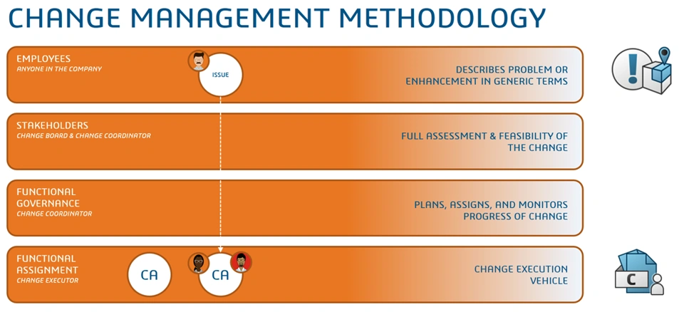

Once users are comfortable and familiar with using Change Actions, if required the change process can be expanded further so that anyone within a company can initiate an issue related to a SOLIDWORKS design, and that issue can then be used to drive a change action. Issues are captured and managed using the Issues Management app available in the Collaborative Industry Innovator role. Issues are a great way for anyone in a company to capture and document an issue related to a design, and then share that information directly with the relevant person or department in their organization.
For a detailed explanation and use case demonstrating how issues can be used in combination with change actions, please refer to the post titled The Basics of Release and Change in the WORKS | Onboarding and Adoption community.

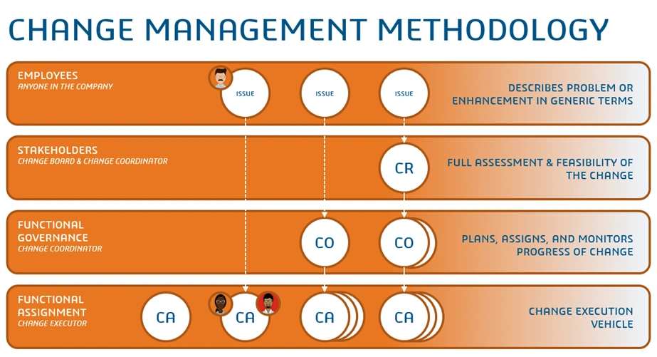

For customers operating in regulated industries that need to formally manage a high degree of change to complex products, the Change Manager role offers a scalable solution that expands on the capabilities of Collaborative Industry Innovator.
Using issues in combination with the Change Manager (CHG) role, issues can drive change orders, and a change order can drive multiple change actions. Issues can also govern a change request that in turn governs a series of change orders, and those change orders can drive multiple change actions.
Specific guidance and best practice related to the Change Manager role is beyond the scope of the adoption guide, but it is mentioned here to highlight how the CSV role capabilities can easily be expanded upon to meet the needs of customers with more complex requirements.
